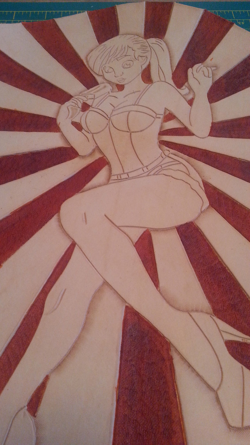

First project on the new slab. Mustang seat pan for my bike. I am so happy how this is turning out.

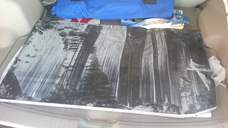

Black slab

Black slab
I like it. Do you get any reverberation from it?

Nope, no give, no bounce. I tool and skive on it and use it with wet/dry sandpaper for wide blade sharpening. Works good and the price is right. Weighs a fraction of what a 1.5-2" slab would. Initially I planned on putting a Hi-den particle board under a slab but ran across a clearance sale of marble and granite at Home Depot first. I figured I'd try it and if it didn't work out, no harm done. Use thin-set next time T-phant, it's cheap and fun to play with. If you don't have a tile trowel just cut some 1/4" v's in a piece of scrap plastic. The furrows are important.
