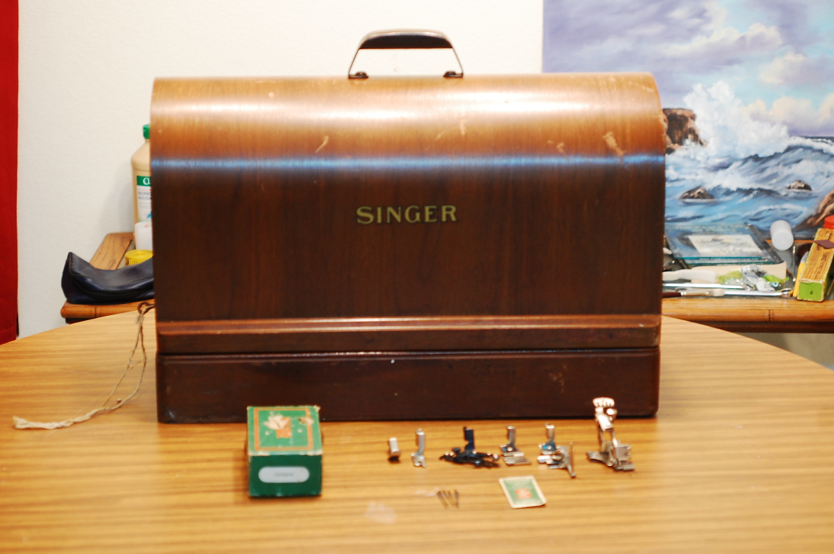

It seems to be pretty complete and came with 7 attachments that I cannot identify yet because my knowledge of sewing machines at this point is still virutally non existent. I am a complete noob.
There are also 7 needles that say Simanco 14 on them. The needle package says 15x1. What does these numbers mean?
I posted photos of the attachments if anyone can help me identify the names of them and their purpose, that would be great.

Forget the attachments. They were meant for sewing light cloth. The only attachment you will probably need is an adjustable edge guide and thumb screw.
