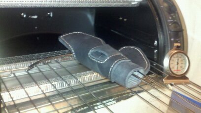

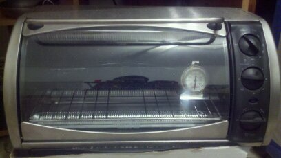

ok here is my set up . I have a little over thermometer to watch the temp carefully , I have the oven on the lowest setting which is rght before the 100 degree mark and I get right below the 150 mark on the thermo so im asuming is is in the 130-140 range and turn it on when I start forming so it can be ready when im done and then set the timer for 20 min and it turns off when done . I cut two of the wires on the rack to i can supend the holster so it wont give it "grill marks" if I leave it to long here are some pics and I picked the oven up off of craiglist for 20 bucks ,

A good rule of thumb is treat your leather like you would your skin. If it would burn you, it will burn your leather.
