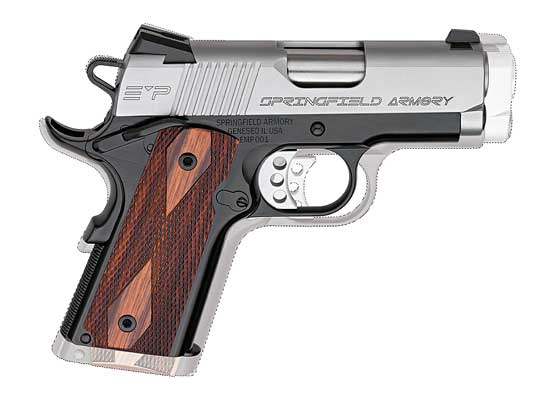

I found this image showing the difference in size between the Springfield EMP 9mm and the 3" Micro .45. It looks to me like the EMP would nestle down inside the trigger guard area, and the end of the muzzle would rest at about the same place as the 3" .45 would in the holster. But it would not be as tight at the top of the slide. I think in a Pancake style holster, this wouldn't cause much problem, but I'm not so sure with the Avenger style, where it's much harder to form fit the double-thick area close to the gun (at least with the pattern I'm currently using). Sure is a sweet looking little pistol that would go great with my Kahr P9... :)
I was wondering if there was any difference in the size between the EMP and the Micro Pistol! I did see that Rings had the Micro Pistol and I ALMOST suggested taking a look at it, but I had a feeling that it might have had to be a little bit bigger, wider etc to accommodate the .45 cartridge. Cool picture Particle, that was the information I was trying to find for you yesterday. :)
I can't say with certainty, but I don't think there are many, if any, parts that can be interchanged between an EMP and a standard 1911. They're completely designed around the smaller cartridge. I believe even the slide thickness is more narrow, but I didn't find any measurements to verify. I do have a Rings 3" 1911 for the .45, and that's what the customer wants me to use. I told him I'd build him a holster for a 3" 1911 .45, but I can't guarantee the fit - he was okay with that. I think I still want an EMP dummy though, as I think there are enough potential buyers out there to warrant the purchase.

I found this image showing the difference in size between the Springfield EMP 9mm and the 3" Micro .45. It looks to me like the EMP would nestle down inside the trigger guard area, and the end of the muzzle would rest at about the same place as the 3" .45 would in the holster. But it would not be as tight at the top of the slide. I think in a Pancake style holster, this wouldn't cause much problem, but I'm not so sure with the Avenger style, where it's much harder to form fit the double-thick area close to the gun (at least with the pattern I'm currently using). Sure is a sweet looking little pistol that would go great with my Kahr P9... smile.gif
Wow, very interesting. I guess I need to be careful on taking John Ring on his word all of the time. I'm surprised he would say they are the same when he is particular about guns like the Sig P228 and P229 non rail which he has different molds for, and the difference is significantly less between those two and the picture of the EMP/1911.
Guess I better get me a duncan mold.
