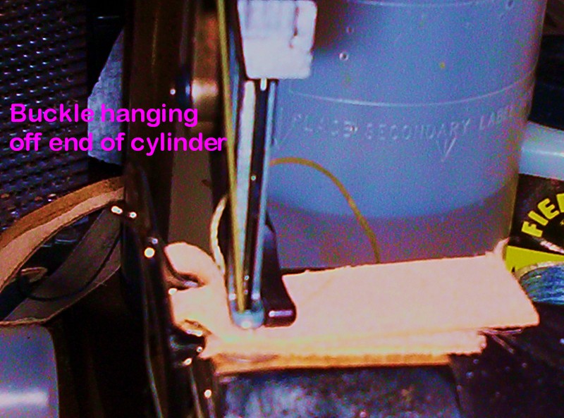

I'm not much of a seamstress, so why am I trying to learn the basics of sewing on an Artisan 3000 with leather and biothane? To drive myself nuts, I guess. I have done a general search of the Web and this site, but can't find anything specifically about how to get the stitches close to buckles. The presser foot gets in the way. If I lift the presser foot, I get weird stitches. What's the trick?
~Jennifer
Use right toe presser foot. Or the left toe presser foot. If you don't have either, contact one of the sewing machine distributors from this forum and they can get one to you. The l/r toe foot is basically half the presser foot, and allows you to run the center foot (where the needle is) right to the edge of something like a buckle. You'll still have to allow for the width of the center foot, but you should be able to get VERY CLOSE.

If you start next to the buckle going down the length of what ever your sewing you can't get real close. But going back up the other side you can sew pretty close to the buckle. Trick is to make sure you enough of a lap so that it is secure. Not sure of that makes sense or not, if it doesn't i try to take a couple of pictures tomorrow.

Ah, now I think I see what you were asking...
Turn the work sideways, and use either the left or right toe foot. You can guide the needle about 1/8th inch away from the buckle...like this-post-5374-007135800 1317603959_thumb.jpg
Is that what you were talking about?
