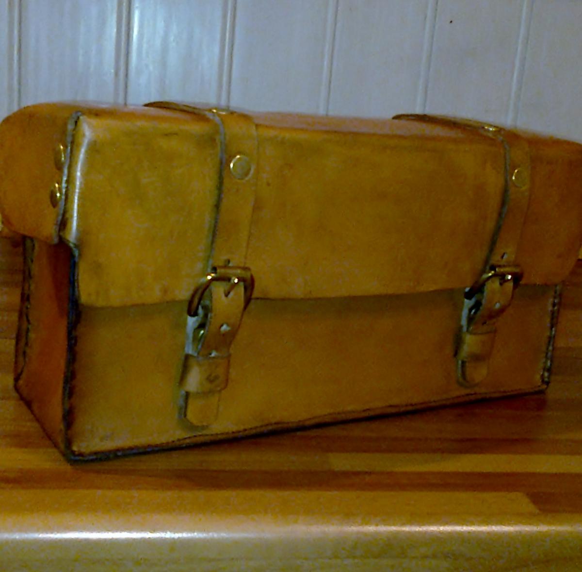

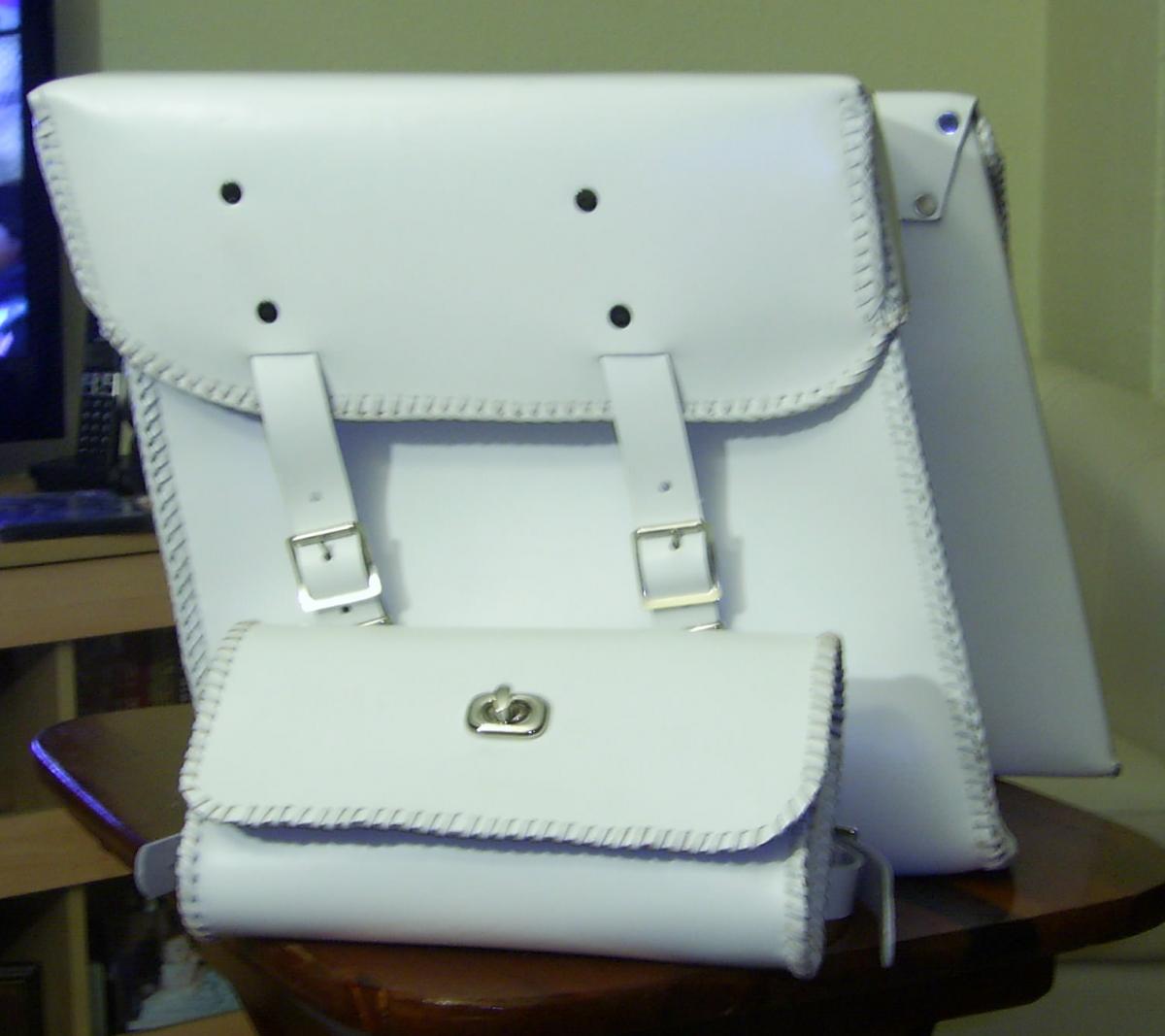

I just draw up a rough sketch of what I want to make,then build it in sections with cardboard and when I got it right with the cardboard I transfer it to the leather then just cut out and stitch or lace/braid..
thats what I did with these,
post-22861-0-08039200-1359734007_thumb.jSaddle bags/tool roll for honda shadow.
post-22861-0-27570800-1359734049_thumb.j vintage style despatch bag made for military style bobber.
The good thing doing it this way is you do not make mistakes on the leather just on the cardboard.
