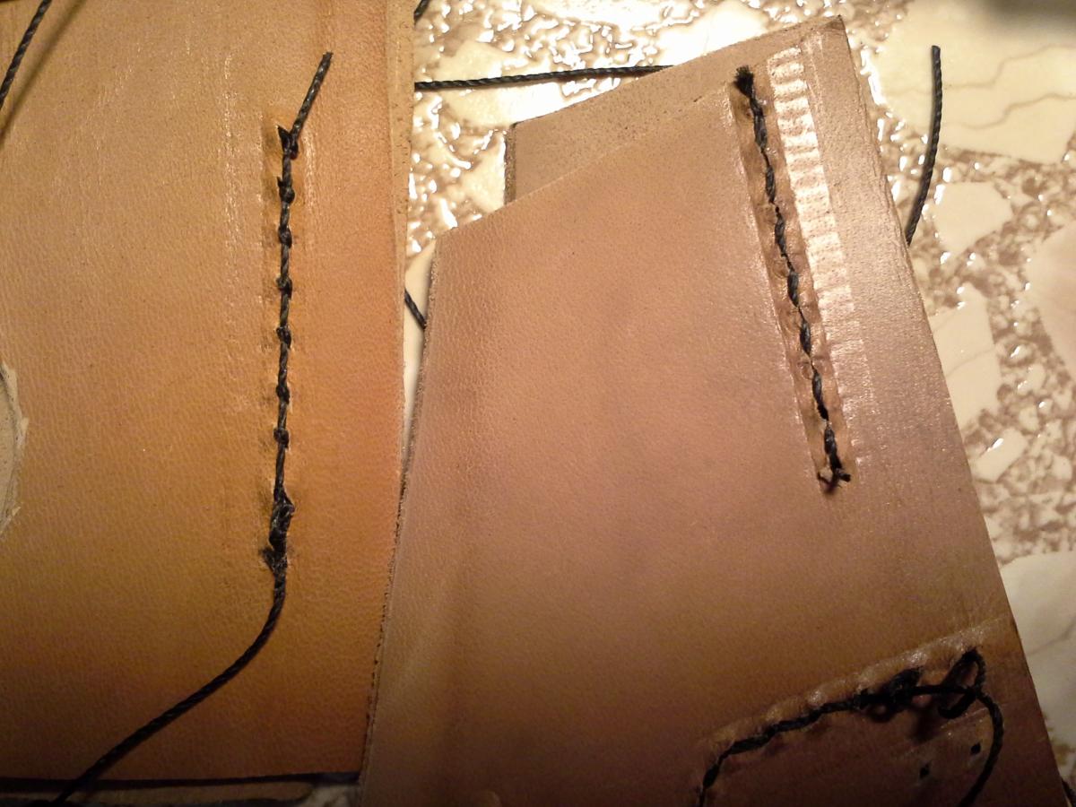

I've searched this forum, and all over the net for a solution to my problem. I have tried everything mentioned, but nothing seems to fix my issue.
I have adjusted the sewing thread tension and the bobbin tension both up and down, but I cannot find a happy medium. As you see in the picture ... the pressure foot tension is either applying pressure erratically or my stitches come out looking like a 'Feed Bag' stitch on the bottom.
I am pulling my hair out trying to get this machine to sew an acceptable stitch, but nothing is working.
Any suggestions before I send it back to Tippmann? This is a New machine by the way.
post-35312-0-80697600-1368079954_thumb.j
Edited by RoosterShooter
Call Tipmann, they can give you basic starting settings for both thread and bobbin tension. I had the same problem when I got mine new. Had to learn by doing. Once you get the knack it easy to adjust for various leather types and thicknesses. Occasionally I get mine so screwed up that I have to take it back to factory spec and start again. Dont give up, its a great machine. Quick question, in your picture which picture is the top and which is the bottom. Can't quite tell. Let me know and I may be able to offer a suggestion.
The picture is of the bottom.
Also, it's on 7 oz. horse hide. Does the material density affect the stitch?

The paint should not be peeling off, as you indicated. Your stitches indicate not enough tension on the needle (top) thread.
Leave the bobbin tension where it is, and then wrap the needle thread TWICE around the Primary and Secondary tension plates. If the loop starts appearing on the top of the stitch instead of the bottom, begin to loosen the Primary tension adjustment some.
Properly adjusting the tension on a Boss can "drive a sane man nuts" - but once you get past being really mad, and do it a few times, it gets easier.
Still, I would definitely call Tippmann and ask to speak to Ben. Tell him Sam said to call him. He will talk you through most any problem you are having, and if there is a quality issue with your unit, he will make it right too.

Ben wasn't in this afternoon, but I spoke to another gentleman who walked me through an entirely different setup process that isn't listed in the manual. It was fairly close to what you mentioned.
Another problem that I was having was that I was using horse butt to sew my test strips. You know as well as I do that horse butt is some of the most dense 'leather' on the planet, and it wasn't a good test subject.
I switched to 8 oz. cowhide, adjusted my machine similar to what you mentioned, and all is well. I had perfect stitches in less than 15 minutes!
