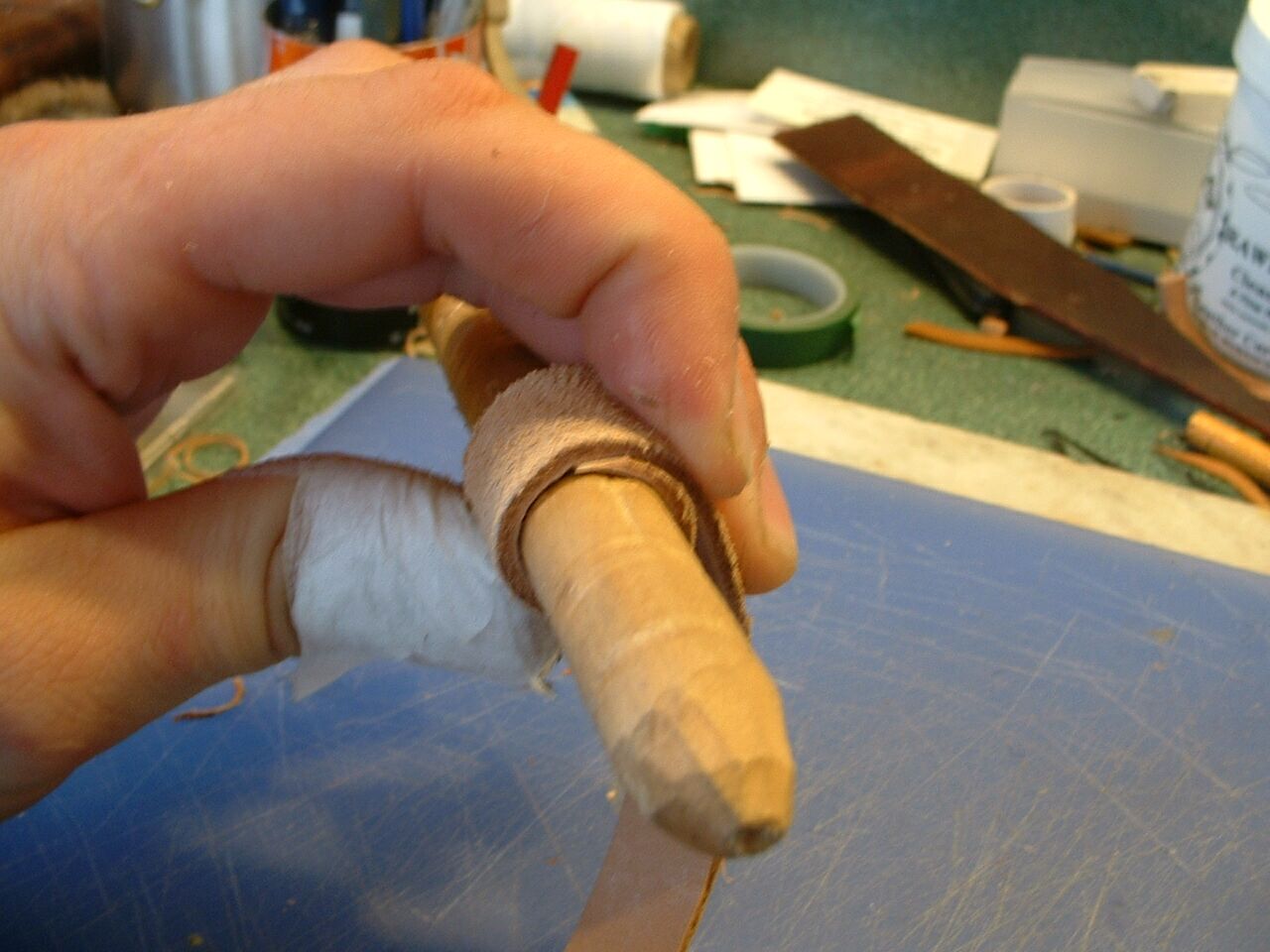

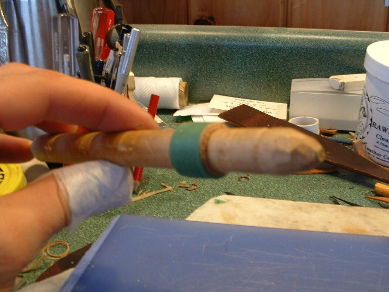

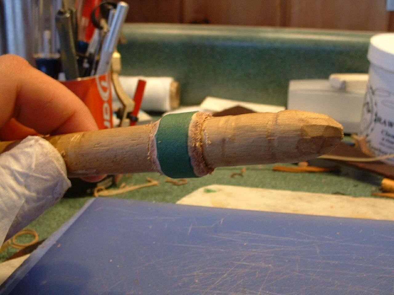

Waiting for some rawhide to case, so I whipped up a slide. and I took pics of how I build it.
Cut a bevel, wrap and match. Tape, shape and braid.
