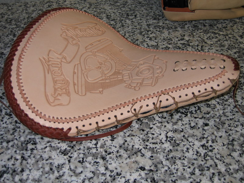

Decided to post the latest seat.It is for a different seat pan so there was pattern drafting involved....one of my least favorite things to do.I ordered my leather from Wickett and Craig. It arrived a day ahead of schedule so I got an early startHere is the first day's work.The seat pan with the patterns attached to check fit.early work on the seat back.

It is going to be far from plain. I'm doing a side view of an evo engine. Kinda challenging at this small size. I'm anxious to see how it turns out.

Now I get to start the part that I really enjoy. The seat front is going to get the full decorative lace treatment. I do love to lace.

The lacing is finished. Assembly starts tomorrow.
Hope you like the results so far.

It is almost finished. I'm sure you will all be glad of that. This has taken a bit longer than I expected. Probably because the seat in rather large and the pan weighs at least twice what my normal pans do. This is a Fabricator Kevin seat pan, it is truely a work of art.
I should finish the lacing this morning. That would leave the staining and finishing for tomorrow.

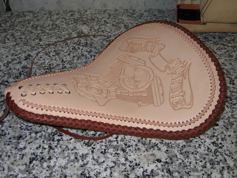

Remember your 4" of foam is mounted to the frame. This seat mounts to a bronze bearing pivot and 4"-5" springs. They ARE more comfortable than they look. Don't get me wrong, they are no lazy boy recliners, but the guys here in Cincy ride them to N. Carolina every year to the Smokeout.

Final installment......finally.
The seat is complete....a little atom wax after it has dried for 24 hours and it is finished then it will be off to California.

Dave, you did some stretching to the leather before carving right?
Did you attach the leather to something to keep it from stretching when tooling?

7 -8 oz leather doesn't stretch much, but it was attached to my tooling board to do the tooling work. The main shrinkage that I encounter are due to long runs of decorative lacing. They tend to compact the leather a bit and "shrink" the seat tops and backs. It isn't a huge amount but maybe 1/8 to 1/4 inch over the length of the seat. It is a small enough factor that they can be pulled back into place when the top is tied to the back in preparation for final lacing.

Glad you like the finish MadMax, it is a combination of medium brown, saddle tan and sheridan paste antiquing. I like the color and hope the customer does too.
That is Leather Balm with atom wax that I use. I've never had it pull up like you describe. The only thing I have noticed is that it has a tendency to turn to a whitish powder after a year or so on a bike. Some saddle soap and a scrubbing with a toothbrush followed by Aussie cream seem to do the trick and freshen the seat up.
I used Lexol on the seat prior to antiquing and really like the even finish it gives to the project. I didn't get any antiquing splotches as can sometimes happen.
