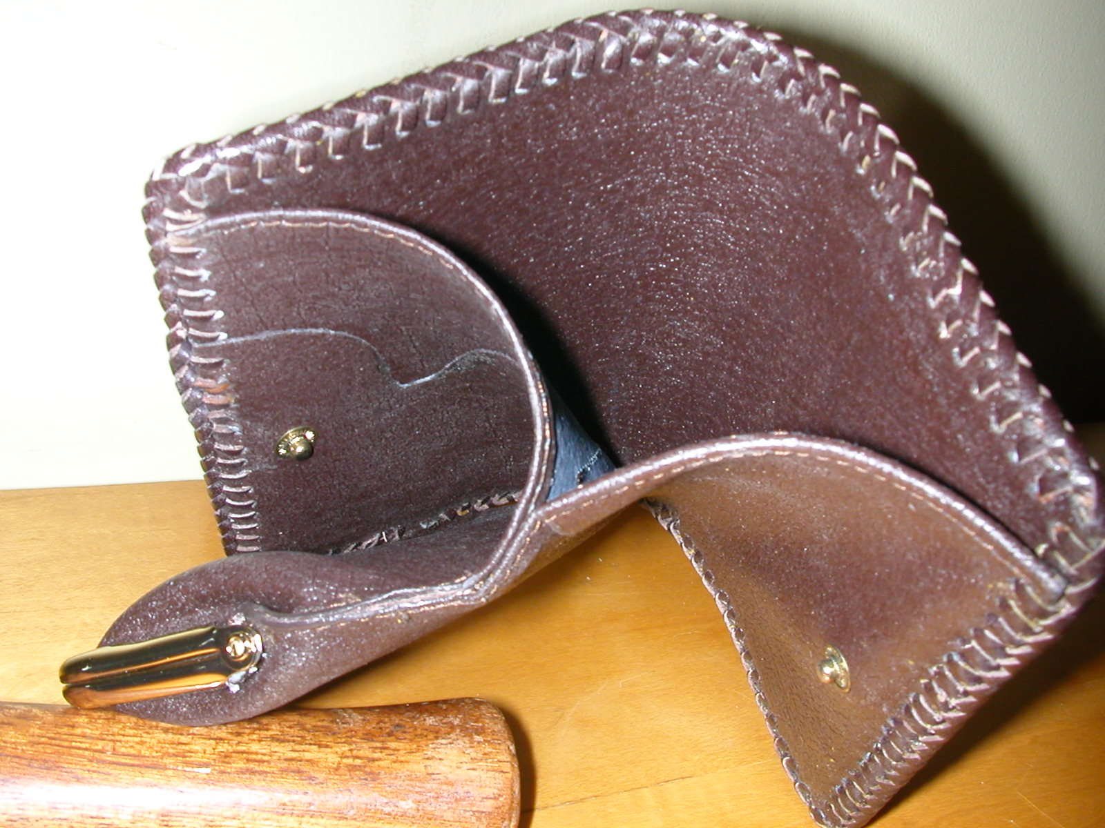

Sounds like a few have heard of it (Mike - gorgeous carving!), but I'm putting up a couple pictures of exactly what I have just to be sure.

DSCN3651.JPGDSCN3652.JPGHoward,
Mike is right, but you might also want to line the back after tooling. Here is one I just finished for my grandchild,hope the photos help.
Hope these photos help.
