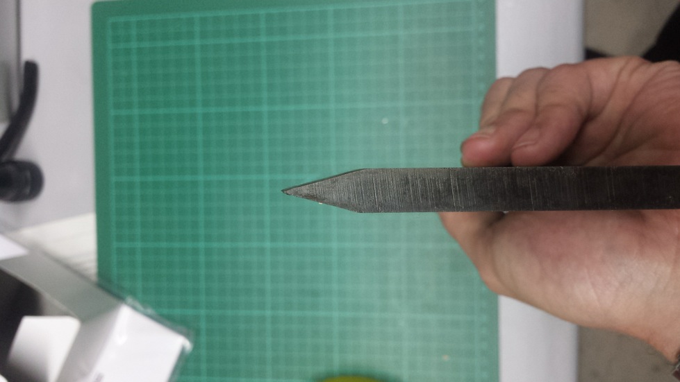

First glance of the blade it looks visually fine, upon a closer look it need some work done.
It looks like it has been rounded and is slightly bow shapes so I think I will take it to get reground so that I know that I have that variable covered off.
The shape of the blade is the same as in the image, number 3.
Is there a specific angle that this should be ground at that I can let the company doing the work know?
Also the edge being the shape that it is, does this make any difference for the set up at all?
Thanks in advance for your help
post-53718-0-85521800-1418013517_thumb.p
In all the splitters I've dealt with over the years the shape should be as #4 and the flat side against the roller. This is how blades are when new and users must work hard to keep that backside flat and smooth with the blade then meeting the roller at TDC. A flatter angle than pictured would also be best. Then, in use periodic honing and stropping to keep both sides flat and smoooth as glass, and the edge straight. Then all the other stuff about roller tension, etc comes into play. But all of that will be like a dog chasing its own tail if the blade isn't right. When basics are right then one could experiment with #1 or #5 shapes on top side as there may be some difference in the finished product based on leather types, useage techniques, etc. When work piece is hand fed (as are 99+%) even the heighth of the machine vis a vis the ht of workers can make a difference. That is actually an angle of approach thing which can change if user changes stance or hand position. In my experience splitters are like some wives (not mine) finicky and demanding but the results are woth the attention paid.
PS It takes lots of scraps and makes a big mess on the floor getting it perfected.

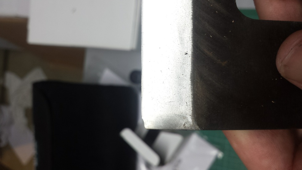

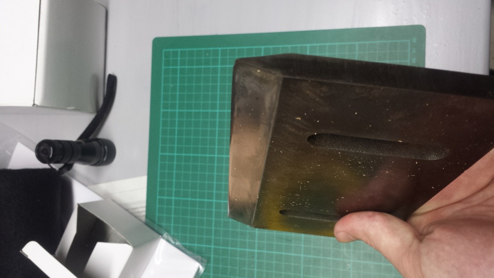

Thanks oltoot. After doing some further research I have found that there are a few blade shapes that are used in splitters. The one that you described and the one that I have to deal with. I have attached some pictures.
The thing sure needs a sharpen, I can almost run my finger along it in the centre without cutting.
It has some damage on the corners where it sits up against the stops, any tips for dealing with this or should I just get it reground to uniform.
I suppose by doing this that I know it will sit flush when positioned.
I can't seem to find any information online with regards to what angle to get it reground at, should I put my faith in the sharpener?

Personally, from the pictures, I would just bite the bullet and take it to a machinist and go for #2 shape, being careful tough not to end up with something so thin and fragile as to have no durability. Perhaps a compound angle such as # 5 would solve that dilemma. This is usually done with hollow ground blades. The long flat major grind would be for enhancing feeding of the material with the secondary not being so steep as to make the results difficult if not impossible to sharpen. All must be done carefully to keep the temper in the blade all the way through the edge. If you go this way, be extra careful with honing and stropping. Do the the cutting slope most rigoruosly and just keep the feeding slopes smooth and slick.
I won't claim to have the kind of experience as oltoot but I must respectfully disagree.
Japanese knifemakers have long known that the optimum trade-off between sharpness and durability is an edge ground on one side only to a simple bevel. That's also the way my Heritage blade is ground and correct me if I'm wrong but I believe that is the way the blades are ground on the Osborne and Campbell-Randall splitters.
The reason I like it, aside from the fact that it works very well, is that an edge with a single edge bevel is the easiest (for me at least) to sharpen and maintain. Very easy to lay the beveled edge on a sharpening surface and maintain that one angle. Then flop the blade over to remove the burr. Easy-peasy. A single bevel edge is also easier for me to set into proper adjustment as I know that if the blade is perpendicular to the roller, I am good to go. Adjusting a blade with a more complicated edge requires greater skill than I possess.
I have my hands full with such a simple single bevel edge. I can make it work quite nicely and wouldn't want anything more complicated.
Maybe oltoot is one of those sharpening gurus though. :)
Michelle
Please note that the simple single bevel was my first preference and the second only offered as a remedy for someting gone a little wrong. Yes the single is easier to maintain.
Obvious to me that this is a different animal. It is a crankstyle and not common to the US. I would try to see if you can find somebody with one over there or Europe and see if the blade bevel is correct. That blade may well need to be that way by design. Changing to a single bevel may change the edge position. This particular splitter may need that double bevel to clear the bottom roller when it is up against the stops (where the corners have chipped out). Those corners can chip out on US crank splitters too. If you allow the blade to sit back from the stops the distance of the chip, they will work without sacrificing good blade in the center.

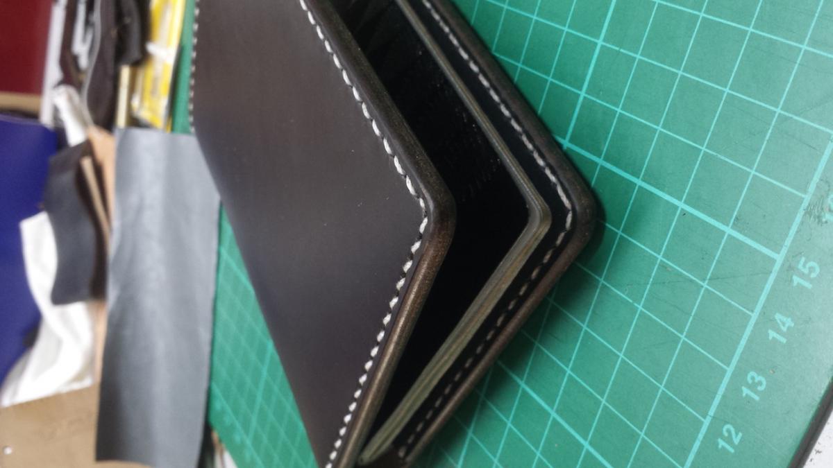

If anyone is interested this is the passport wallet I made with the splitter
post-53718-0-74569500-1423638562_thumb.j
post-53718-0-12593000-1423638566_thumb.j
