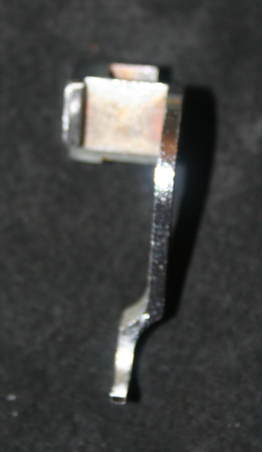

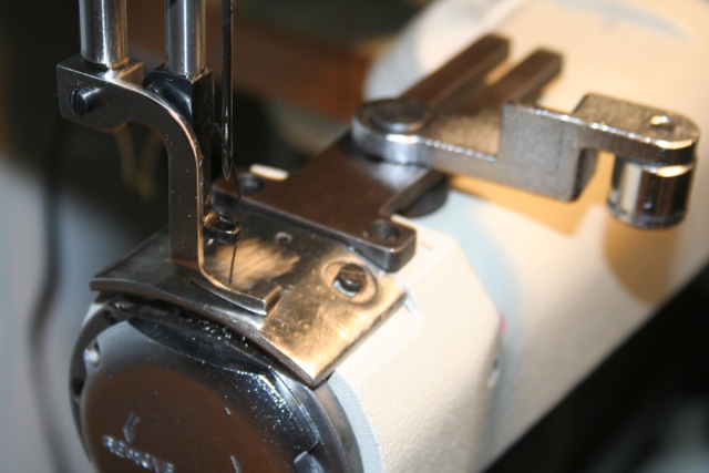

As you can see I have a raised needle plate but I do not know how to use it.Artisan has a double toe presser foot in the mail for me as we speak.The presser foot in the pic was a double toe but I went cutting before I knew what I was doing

I'm also going to try sawing off the lt. side toe on my double toed foot. The reason is because my dedicated rt. side presser foot comes down on the slope of the raised stirrup plate, rather than on top of it. You already have that sawed off foot. You may need to bend the rt. toe in so that it does set down atop the stirrup plate.
I've also noticed that for getting close to objects and using a flat plate, a slotted, feeddogless plate works better than the flat plate you have shown, which is the blanket, nylon flat plate with protruding feed dog. The flat slotted plate I mention does not and cannot use a feed dog. Instead there is a ground down feed dog that moves below the slotted plate and acts merely as a needle guide but never comes in contact with your material. The result is better stitches, especially for intricate work.

Hi Ed
Yes, I did modify the presser foot in the picture.I was talking with Steve at Artisan ,he told me the people trying to sew close to buckles were sawing the tip of the presser feet off.The presser foot,on the machine, in the pic was oriniginally the same size as the foot in the picture laying on the desk.That sawed off foot is not always a good thing.Sometimes when I'm sewing with the short foot it pushes the work out of the way if it has to step up on to additional material.The way this machine is set up it ,the walking foot does not step up very high. Does Artisan sell the Flat Slotted Plate/Feed Dog combo you mention?

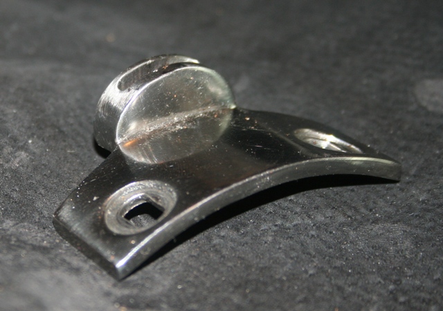

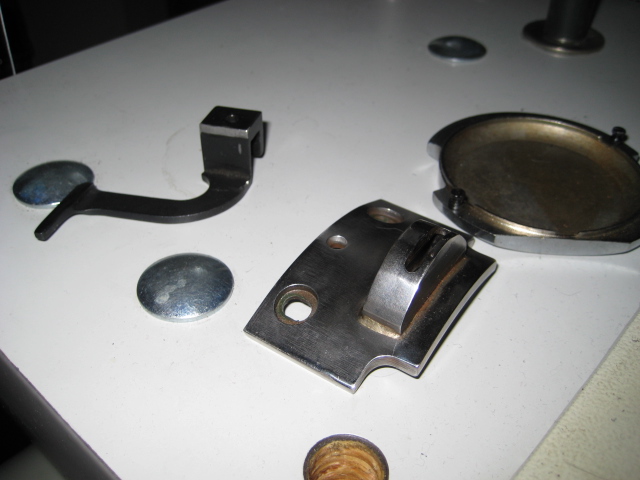

Hi Robin,
Here are some of the feet and needle plates I have. With the rounded raised needle plate, my machine misses too many stitches, which I think is in part to the steep slope of the needle slot that allows the needle to deflect too far in front of the hook.
I should think about giving the plateaued holster plate more of a chance to prove itself, even though the rounded plate makes tight corners better.
