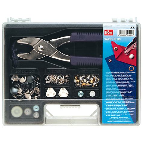

If you are using eyelets, use the appropriate eyelet setting tool. Everything else is just messing around. Don't know if you can buy Prym stuff in the States or not, but they have a setting pliers with all kinds of inserts for just these kind of jobs. Looks like this: post-58609-0-52127200-1433744589_thumb.j

Thank you for your reply! Very helpful info! I picked up some more setters, so I am going to give eyelets another go.
