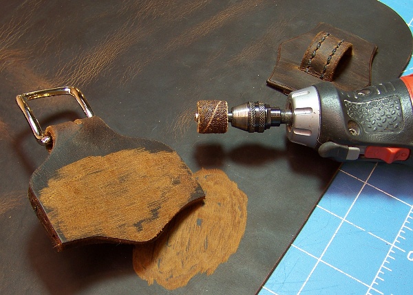

You can glue oil tan leather grain side to grain side if you rough up both surfaces.
