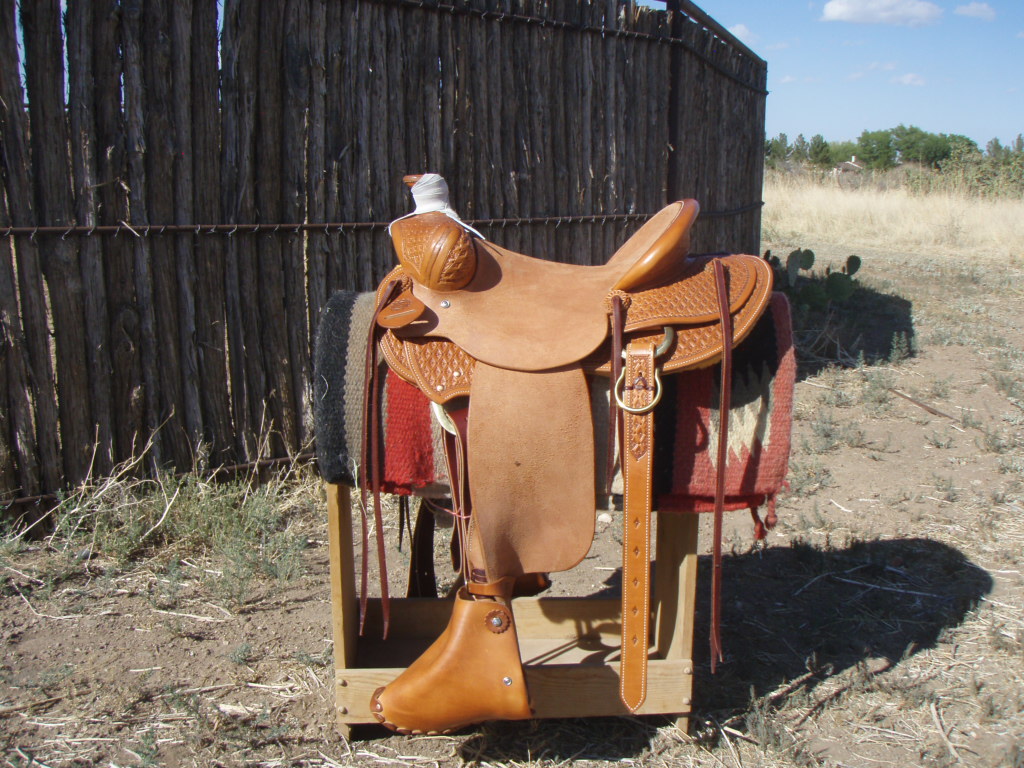

This is number four for me. 15 1/2 Tucson from Sonny Felkins. This is going to be my personal rig. I had to get the pictures before I got the holes punched in the billet or the camera was leaving. I still have a lot of room for improvement so any critiques are welcome.

Looks great! I like the pattern, different, and interesting. I like it. Looks like you are western Texas. cedar pole round pen,prickly pear cactus, juniper "trees". Looks just like my place In New Mexico.... ready to burn.
Looks great CW, nice job!
I'll try to get some pictures of green grass and shady oak trees for you and Rufus James :cowboy:. I can say that now but last summer MO started to look like west TX too...
Thank you all. I can take no credit for the stamp pattern. Jeremiah Watt made the stamp and the original design. JW Wright uses it a lot and was kind enough to give me some pointers on running it.
I have a question for you all, Do you use tacks or some other method to secure your Cantle bind when shaping it?I have been using tacks and am not satisfied with the results. If you look at the third picture you can see where the stitch line is distorted. This was where a tack was and as the bind dried it puckered at the stitch groove. I need to find a better way.

As you can see I am still struggling with that back housing line covering my rear rigging leather. I made a new pattern and then trimmed off too much at the final fitting.
