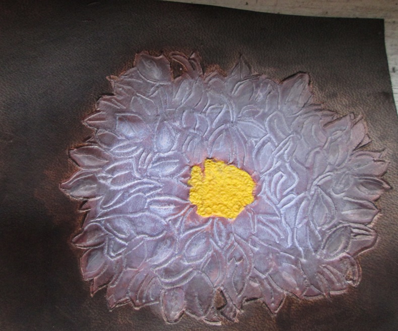

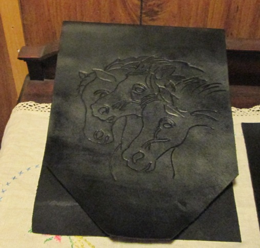

One thing I saw you left out was a swivel knife and a beveler. I just went and saw SLC has the basic 6 set with a swivel knife (and beveler) here http://springfieldleather.com/29330/Stamping-Tool-Set%2CSLC-Basic-7/ I think it's worth buying the basic six because you don't have to use them for Sheridan type tooling but the other five make nice edge designs, etc. I know you said you didn't want to do Sheridan but I still use these for other things. I'll post a couple of pictures.
Other than that I think you have everything to get off to a good start except leather. If you tell me what you want to try to make first I can help you with that too. BTW I get almost all my things from SLC. Really nice folks. Oh wait I forgot I would get a modeling spoon with a rounded point on the other end. I use the spoon to smooth out the beveling and the rounded tip on the other end to draw my designs on the leather. Well they don't have one tool like I have so I'm going to show you two, which I have one each on mine. http://springfieldleather.com/29154/Modeler%2CMed%2CLrg-Round-Spoon/ http://springfieldleather.com/29155/Modeler%2CMed%2CLrg-Pointed-Spoon/ You might want to look at Hobby Lobby etc. for this instead of buying two tools.
