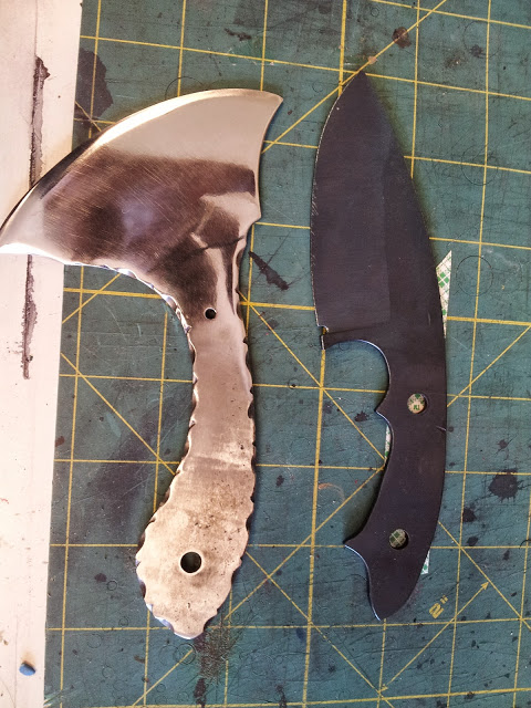

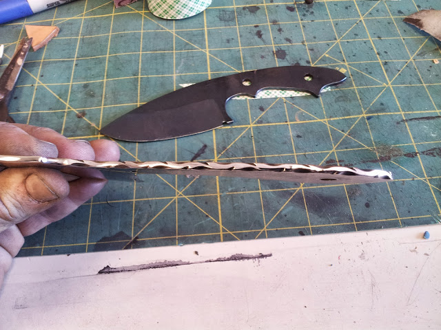

tired of the quality of things purchased I made my own. its made of sawmill end cut blade (most likely L6 or 15N20 steel) it heat treated fine (triple heat treatment and temper) the handle is a micarta that was made for me by my wife. woah!!! the third pic is huge sorry! and the finish on the handle suits me the glass finish it had was to slick!!

stealfdawg, that is one nice looking knife. I need to start making my own knives. Just have seen too many cool looking knifes and it makes me want to build my own. Something about making stuff yourself that has a different meaning than just buying one doesn't fill. I like making stuff for my own use.
