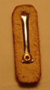

I bent a spoon today and it looks great!
post-19342-045712800 1296770794_thumb.jp
post-19342-096266300 1296770811_thumb.jp
post-19342-024545100 1296770828_thumb.jp
Well this little job is done, already to stitch to the case when I get my leather.
post-19342-061805100 1296790614_thumb.jp
post-19342-058545500 1296790620_thumb.jp
Nice job Tree Reaper. That would make a great clip for a knife sheath, and since I'm a cheap SOB, I take the spoon portion, flatten it out, put leaf 'veins' in using a hammer and chisel, bend and fold slightly, add some color with heat treating or acid and foila! I now have a leaf I can tack weld to any of my BSing-BSing for the uninitated is BlackSmithing- projects.
I put this together today, room for improvement but I'm happy with it for my first eye glass case.
I'll do better with the next one.
Thanks for looking!
Kevin.
post-19342-065313300 1297478616_thumb.jp
