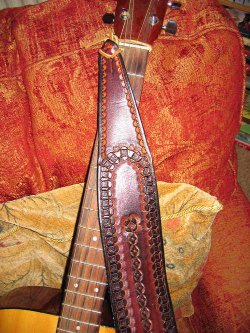

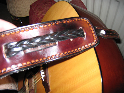

This is how I made and fixed my own strap - It is far from perfect but it works okay for me. Picture quality is a bit shakey here and there... sorry!
The bottom end adjustment uses a single snap which I find perfectly adequate although I would rather have dispensed with any metalwork for the sake of the guitar. It is a working solution and I have never been bothered enough to change it.
I didn't realise how much dust there was on the guitar until I took these pictures - you just can't get the staff these days!
