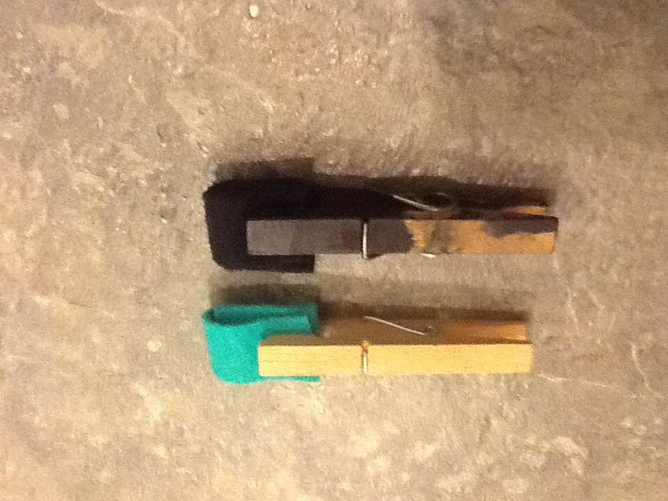

I use a piece off 100% wool felt folded over on itself and held with a clothes pin. When the edge gets fuzzy, I just sear it with a lighter. I found that it works better than any thing else I have tried. Thank you, Al Stohlman!

Bill. Be sure to use good quality wool felt. The other stuff just falls apart.
Thanx Again, Bob -------------------- Wild Bill46

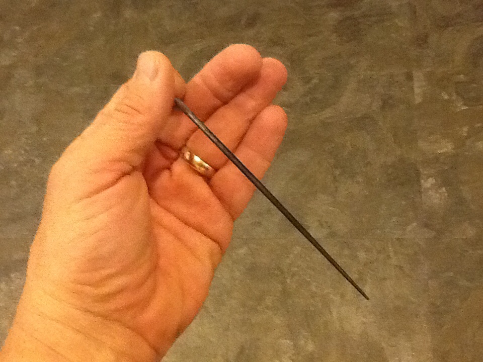

I have found that a tiny rat tail file will give me the cleanest lines without a mess.
Just dip the end into a dye bottle - the grooves on the file pick up the dye and when you slide and twist the file into the hole or slot, it releases the dye. The only downside is that unlike an absorbant Qtip you have to reload it several times for something like a belt slot.
Might be worthwhile trying it.
Here's a pic.
