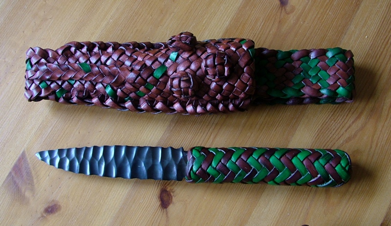

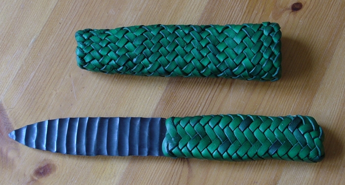

attached a few photos which might help show the possibilities - made the knives as well;
A small dirk knife - used a small extended pinapple for the sheath leaving the both ends open slightly - but is long enough to hide point.
Another small knife, this time I made two long flat braids - one for back and strap and another wider one for the front, sewing them together.
