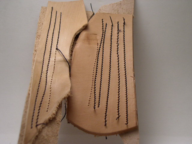

Just started to mess with my neels5 here are a couple of photos for comment and advise. I am still trying different tensions etc. and learning what all the knobs and moving parts actually do. As you can see there is a slight angle to the stitches on top but appear straight on the bottom. Front looks ok for a beginer but the back sucks, looks as though the thread is actually tearing into the leather.
Jordan, I'd say that you don't have enough tension on the top!
