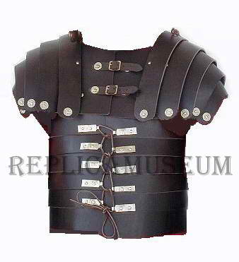

Some time back, I picked up my alter ego, the "Centurion of Capernaum", and had to create my own armor for that.
I used the three different styles I've pictured to get an idea of where I wanted to go.
The black one and the tan one are both made up of strips of leather, . . . they are laced together up front and in the back, . . . and use tabs that are secured by the rivets you see next to the lacing taches on the front.
The tabs are separate pieces of very supple (like suede) leather, . . .
Those styles are very, very, comfortable, . . . easy to move within (I guess that's why the Romans love it so well).
As you can see I chose the red roman style, . . . the one pictured is made of very thin, supple leather, . . . mine is made of about 14 oz leather, . . . treated with resolene finish, . . . heat/water molded, . . . and is really stiff.
Have fun, . . . don't get in too much of a hurry, . . .
