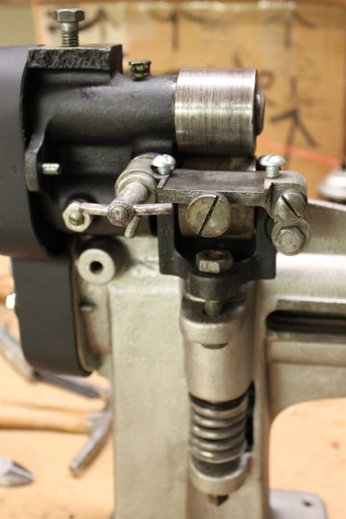

post-15740-050677700 1339286709_thumb.jp
ferg
Ferg, I have had Americans that had the eccentics, My American Model B on the bench has them too. I just played with it and can go up with one and down with the other and splits a 3/4 inch strap pretty level. It is pretty limited with the range, but gave me a 7 oz split. I have only had one Landis 3-in-1 and can't remember how it adjusted. I just got a Landis crank skiver like this one pictured and it has the same slots and bolts adjustment. I can level the blade on thts Landis and have a little more room to change height than my American.
Ferg.
Is that a Landis or American? The adjusting set up looks pretty similar to the Americans I have had. I haven't had many Landis skivers, but the ones I have had and the one I just got haven't had eccentrics. On the American I have right now, I have two eccentrics. One is up at the top left looking at the picture you posted. The other eccentric is where that hex bolt is on yours. I can't tell from the picture if that is a washer or a eccentric under that hex head. By raising that eccentric up and lowering the top left I can level the blade. This Model B is a kind of a cool skiver. It had a milled wheel top and bottom. We took the teeth off the top to keep from marking the grain. There is a lever handle to "open" up the gap between the feed rollers and that gap is adjusted with a nut on the handle linkage. It also has a 2-1/2" blade which makes it really handy for longer skives.

I haven't been able to level the blade on the Landis, I tried to do it a couple of times but haven't had any success I believe it's due to the vertical slot not being long enough on this one (bolt under blade on the outer edge). Also tried to replace the top roller as I needed a completely smooth roller at one time but found the key slots are completely different to what they use now on the 5 in 1 and I didn't think to check that before I got Cambell Bosworth to make a new roller, did find out it used to be green though. It would of been nice to be able to get the blade level but it has had a pretty good workout even without that function.
