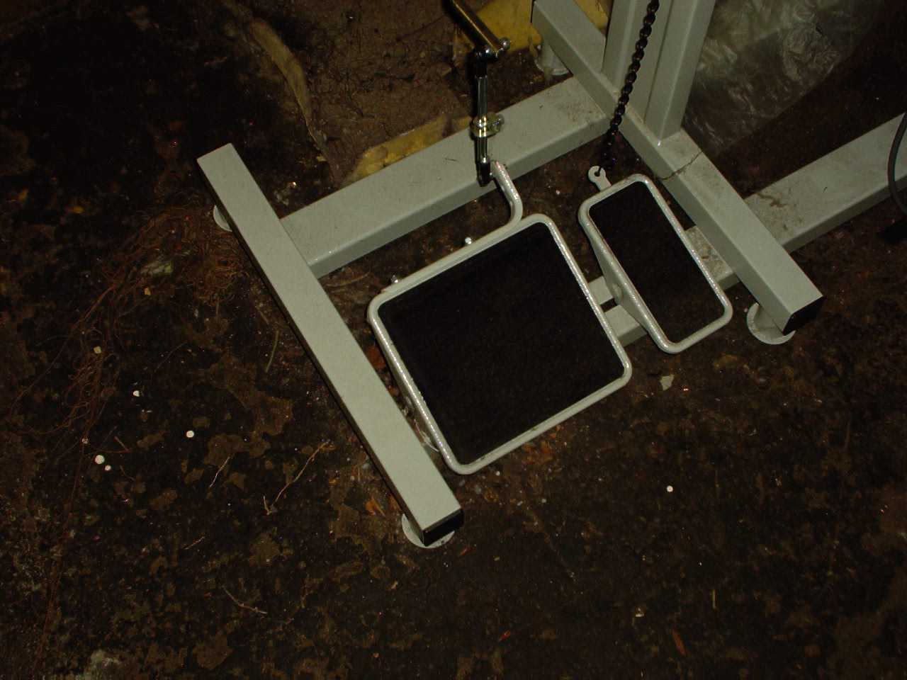

Hi Ray,
The stand/bench I am using, with our machine, is perfectly stable, I have had no problems with it at all. Although it is very similar to yours, the bar/plate to which the pedals are mounted is longer and more robust, in fact I think that there are actually two, parallel bars.
I think this may be your problem.
Steve

Hi Ray,
Steve
Hi Ray,
Yes, I was right, I've just checked and taken this pic! The stands that I have here, are a lot more heavily built than yours, and more suitable for the longer arm machines. If you like, you can exchange the one I have our 45K25 fitted to, with your bench, the 45K has a much shorter arm and your lighter bench would be OK.
Steve
