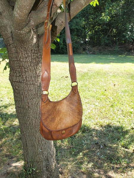

you can make it the size you need, i usually make mine
7" wide .....8" deep

There as many types and styles of bags as there are BP rifles. Since these are simple bags to make you can just draw yourself a pattern on cardboard yourself. I have made hundreds without having had a pattern. It is basically up to your imagination as how to make it. Some are sewed, some are laced together. Some have beaver tail flaps, some have rounded flaps and some have squared off flaps. I have made some from deer that had jagged edges.
Straps can vary from canvas to leather. They can be attached to the back or the sides. More of preference than anything. You can make your bag to look new or antiqued. I have taken vegetan and distressed it to look 100 years old. There are several ways to make them look old. From using old worn looking leather to taking oven cleaner to age leather. I once bought an old leather jacket from a thrift store for $5.00 and used the leather to make an antiqued looking possibles bag.
