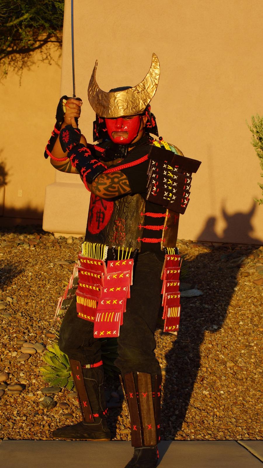

Hey Gequinn, you started this post 4 years ago so I don't even know if this would be relevant anymore but I recommend picking up the book Arms And Armor Of The Samurai by I. Bottomley & A.P. Hopson (http://www.amazon.com/Arms-Armor-Samurai-History-Weaponry/dp/0517103184). I used that when making some armor out of papier mache with cotton as well. I found that book extremely helpful and a good read!
One day I want to make another suit out of leather.
post-63516-0-10762100-1436028144_thumb.jpost-63516-0-65232200-1436028145_thumb.jpost-63516-0-66934900-1436028146_thumb.j
