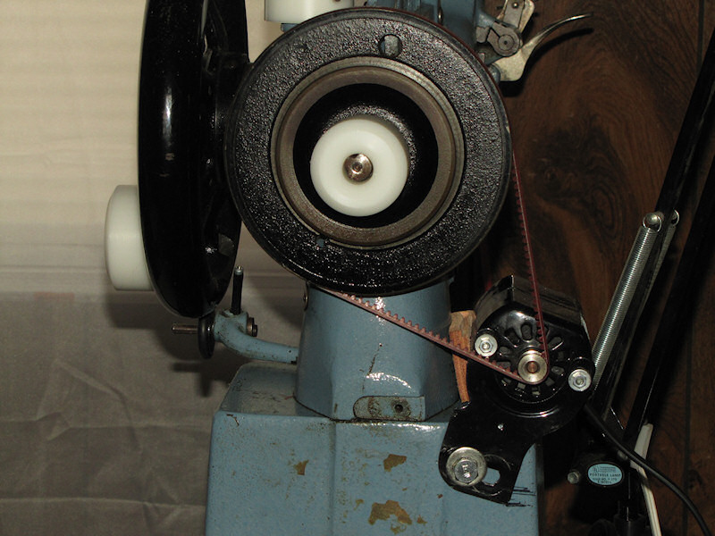

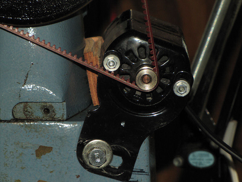

Thanks for reminding me about this. Here's your pictures of the 29K172, equipped with an AlphaSew 1.5 amp motor and transistor controller, running the big pulley with a 23" x 1/4" inch cogged belt. It penetrates 1/4 inch of black strap leather with a little effort, and 1/8" like butter. Unlike the leather drive belt, this belt does not slip at all.
Amazingly, now that I am able to use both hands on the leather, this setup sews 5 stitches per inch into 1/4" of belt leather, at maximum foot lift and bottom-most stitch regulator settings (where you can still use the lift lever). The presser foot activator has almost no appreciable free play.
post-11118-057258200 1315158225_thumb.jp post-11118-009373300 1315158229_thumb.jp post-11118-005465800 1315161358_thumb.jp post-11118-031961100 1315161362_thumb.jp
The triple folded piece of 8 oz belt leather secures the motor against the back of the head, preventing it from being pulled up under strain. My preferred mounting place was completely along the back of the base. But, I can't find a cogged belt 27.5 inches long to mount it there.

Wizcrafts - Thanks too for the pictures, it's always a big help. I like that setup and think I'll be doing this. The leather shim's not a big deal but it would be nicer with the 27.5" belt. Maybe a crazy idea but do you think an auto parts store would have a longer 1/4" belt?
Hey Wizcrafts, I was just thinking..... with your setup (handwheel on the front) the smallish motor doesn't have the added weight of the handwheel/pulley combo to try and turn. Do you think the combo would make a difference for the motor's ability in this application?
