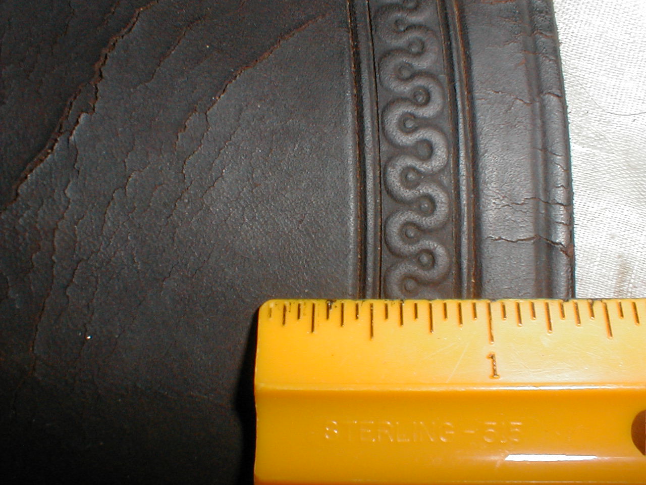

Hi,
I am new here and new to leatherwork. I recently bought an antique saddle that is missing one of its fenders and I would like to make a replacement. The rest of the piece is easy to make as I am fairly handy but I dont know where to begin on recreating this design. Was it stamped in? Any help would be much appreciated.
Thanks,
Phil
This is what's called in the saddle trade, a "San Carlos" border. It can be made with several types of "meander" tools, found at places like Tandy, or other suppliers, or toolmakers. Not sure if that exact tool is being made, but you could have one made if you have the need to duplicate exactly.
Do a search right here on this board for "San Carlos", "meander", or "border tools", and there will be many mentions, and tips as to how to do this.

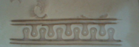

Hidecrafter's has that stamp, Tandy has one similar, the hidecrafter stamp is a Craft Japan E683. Barry King makes one as well, but it's probably too expensive for just this one fender remake.
Here's a picture of the hidecrafter stamp impression.
