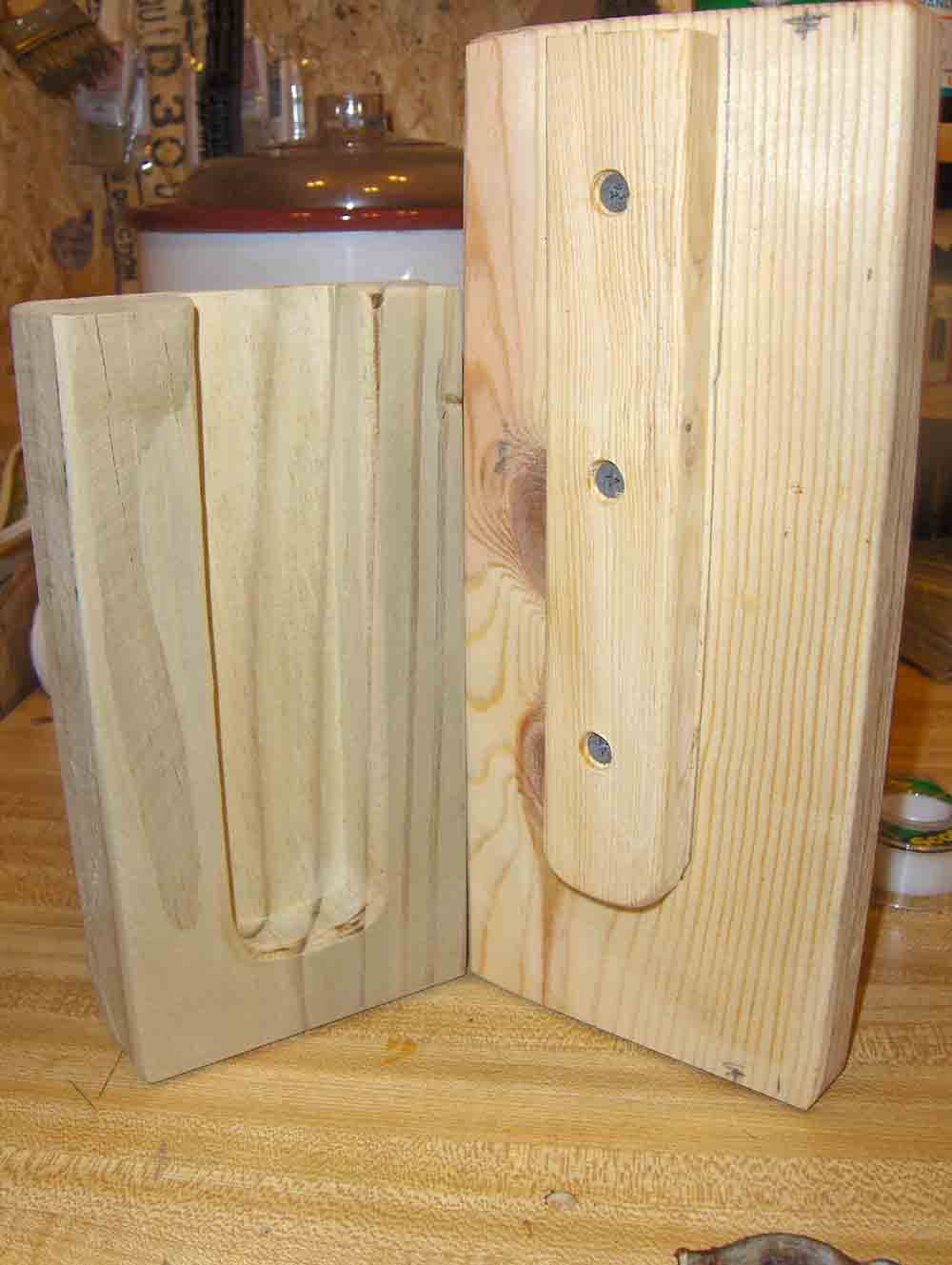

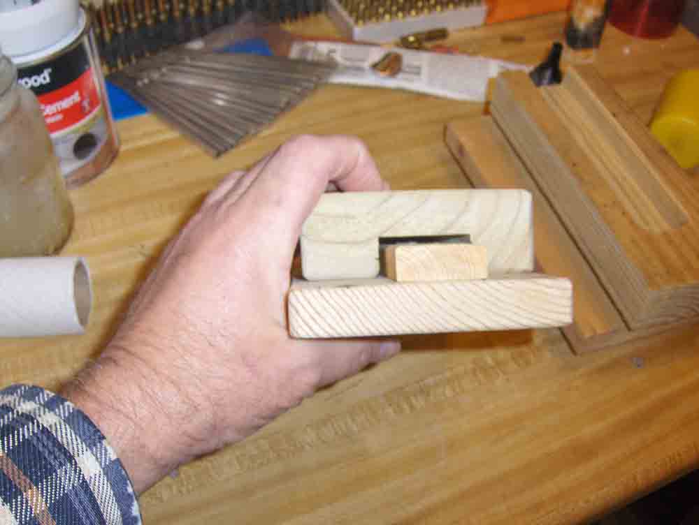

swirve, . . . ummm, . . . I'll try the picture thing, . . . 276 shows the mold pieces apart, . . . 277 shows and end view and clearly depicts the clearance needed for a good mold. I usually make mine one full oz wider than the anticipated weight of the leather I will be using for the project.
Picture 278 just shows the mold laying down together. I, . . . ummm, . . . SOAK or DROWN the piece of leather I will use in my molds and I use the HOT water straight out of the tap. It's not hot enough to scald you, . . . but it is too uncomfortable to be in it very long.
Obviously I lay the female mold down, . . . cover it with the soaked leather, . . . force the male form down into the leather, . . . whack it real good on the rounded end to force the rounding to work, . . . tighten up a heavy duty 8 inch "C" clamp on the whole thing for about an hour, . . . loosen the clamp, . . . remove the leather, . . . hang it up to dry for a day or so, . . . then cut, sew, . . . whatever to finish the project.
