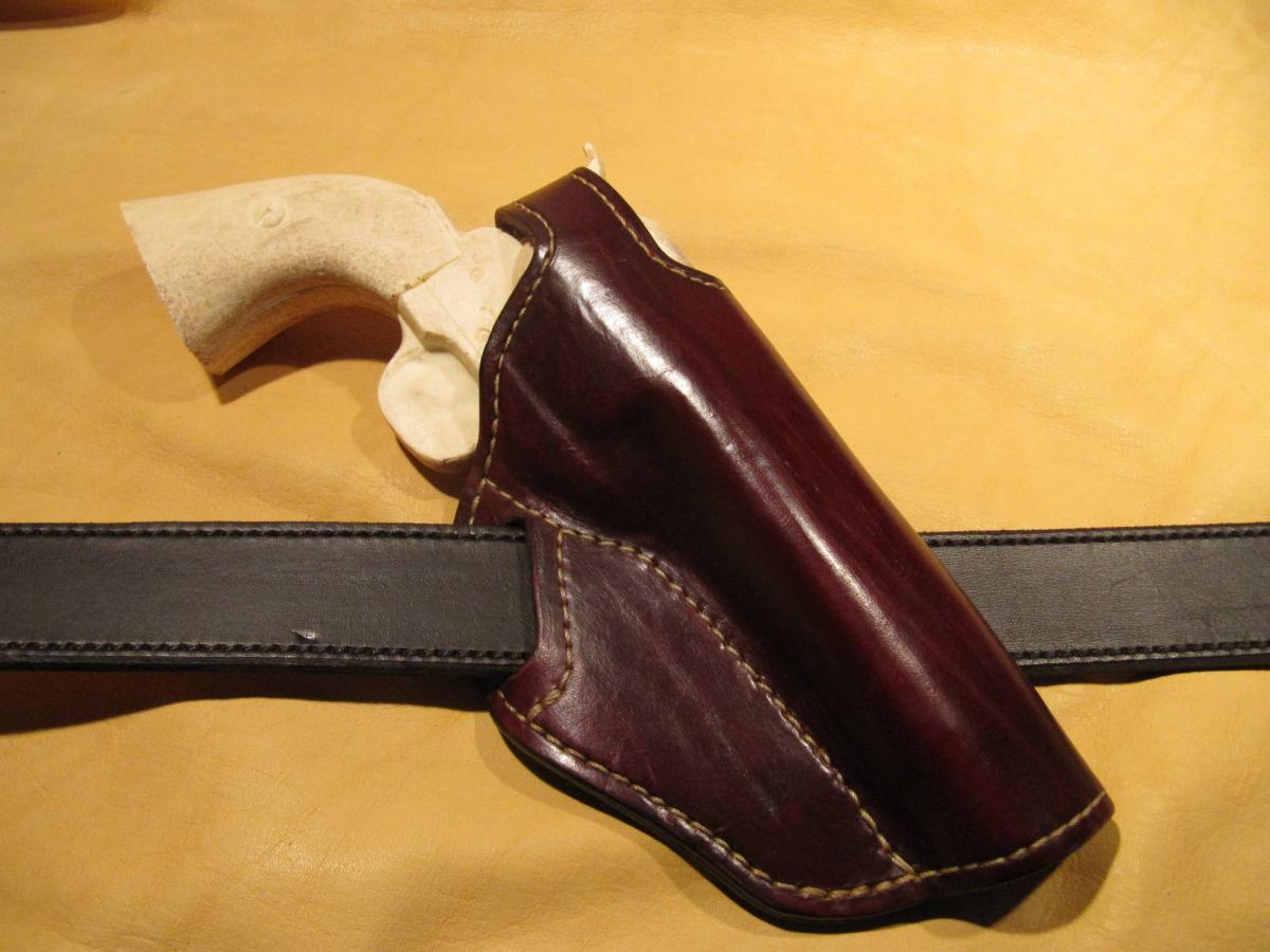

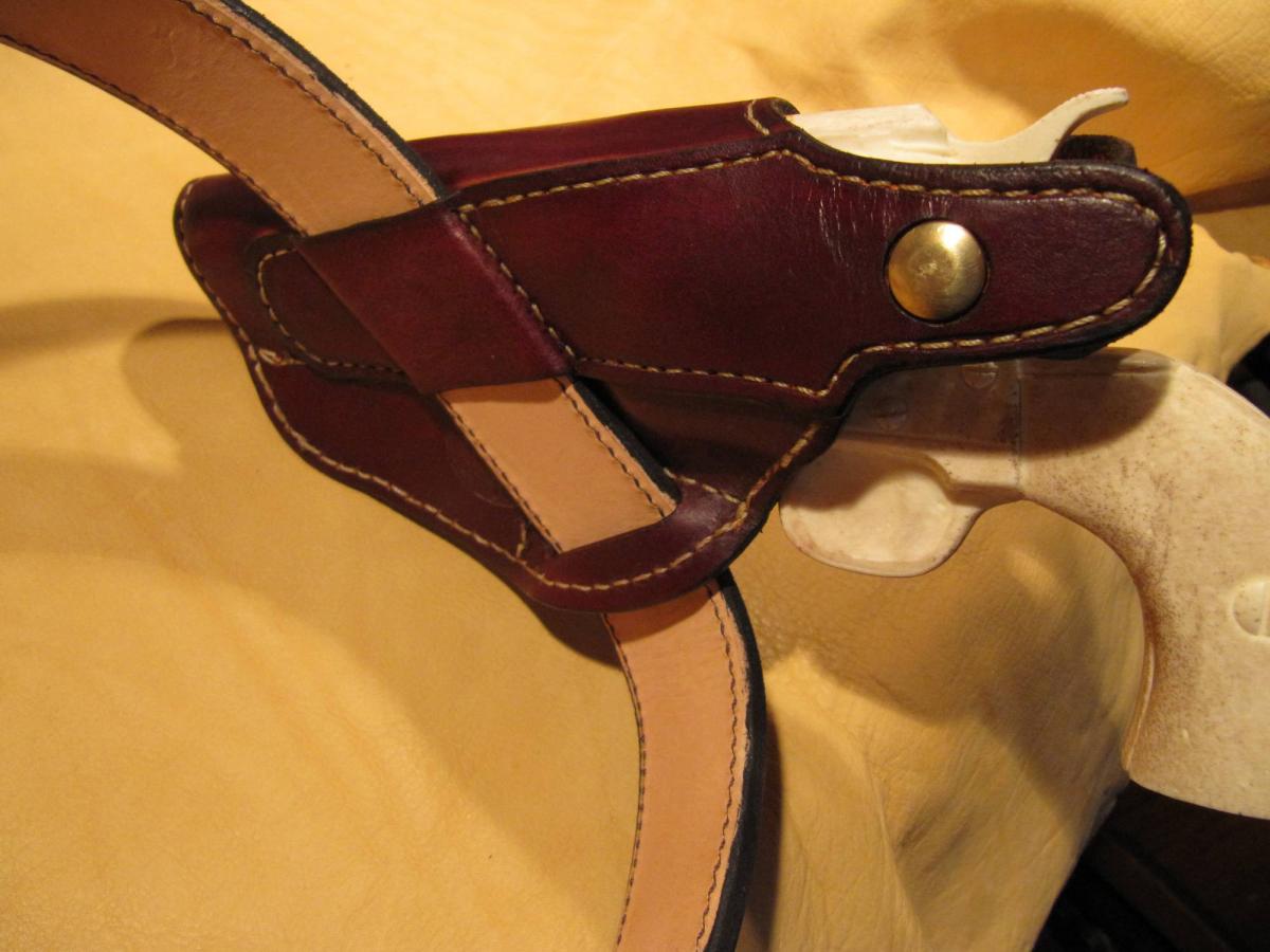

Just finished this one (need to do alittle work on the edges yet). Customer wanted a cross draw for concealed carry of his Vaquero. It is more or less based on an Avenger style holster but set up for cross draw. Customer also wanted a thumb break on it.

Nice, customer should be more than satisfied.
Pounder and Greg Thank you. Greg single action were being used for concealed carry by gamblers, city dwellers and others long before the double action came to be. Becuase of the grip configuration they are a little harder to conceal. THis holster seems to hold the grip in toward the body fairly well.
When you get the wheel gun in there, . . . loaded, . . . how is the balance?
It looks like it would be a bit top heavy and try to ride out, . . . hope it don't.
May God bless,
Dwight
Dwight, the balance seems to be pretty good.I agree there is a lot of weight right above the belt. Most of the cylinder sits right above the first blet loop. The loop in the wing seems to hold the grip in toward the body fairly well. The belt loop tunel seems to keep the holster fairly stable. The customer is wearing it wiht a double layered concealed carry belt and says he is very happy with it.
Cross draws are problematic in that too low and the leather gets in the way. Too high and the balance gets in the way.

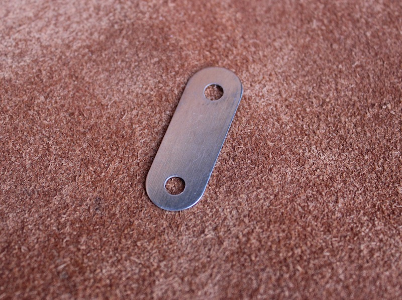

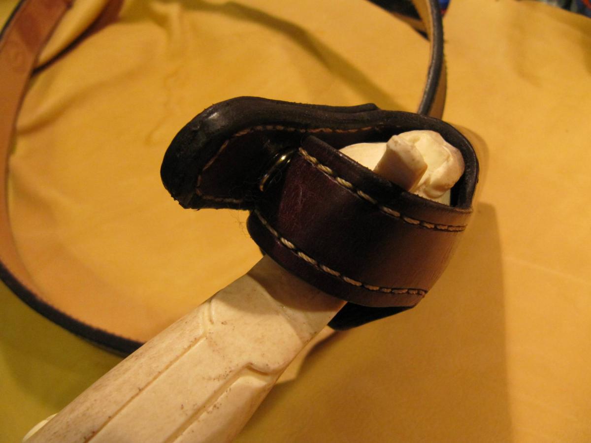

Nice, what do you use for a stiffener in the thumb break?
Lou, normaly I put a stainless steel stifiner on the back of the thumb break tab, on this one I buried the stiffiner in the layers of leather. The snap cap passes through the bottom hole of the stiffiner. I get my stainless or black stiffiners form the bluegunstore.com
