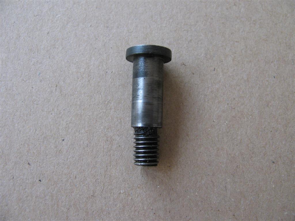

what parts do you actually need - do you have a parts list or can show me pictures of the parts. I once disassembled a 45K1with a cracked housing and still have some parts floating around but I have not assorted them so I have to see pictures. Parts number alone do not help.
Well sir, on the right side of the #2 photo there is a large slotted head screw with one of the upper connecting rods on the end of it. What looks like a very dark line on the left side of the connecting rod is a wear gap. I can move this part left and right and it makes an air bubble on the shoulder of the screw. I think it is the G94 screw on the 1876 parts plate but I am not sure.
I also discovered that the shaft that drives the shuttle has a tappered pin in it to hold that part in place. There is no way to change the location of the hook unsess you remove the pin.
I have this one - looks close but I´m not sure:
Head diameter: 12mm
Length w/o head: 27mm
Thread length: 9.5mm
Thread diam.: approx 6.6mm
Shaft diam.: 8mm
What do you think?
post-31854-0-51607600-1441213864_thumb.j
I do believe that is the screw I need. Is it for sale if it is how much would you like for it?
