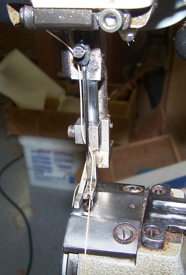

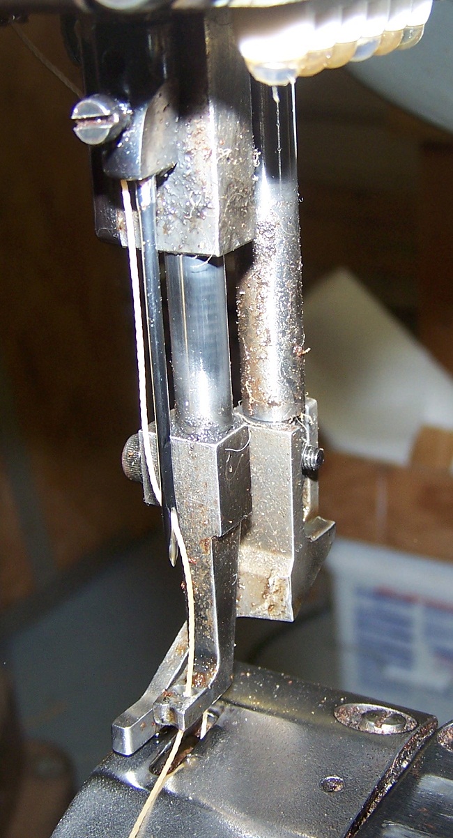

Here's some pictures of my machine. It's a Juki Ferdco Pro 2000 if that's makes any difference. These may be pictures of what you were asking about, if their not ill take some more for ya.
post-11301-038906600 1343798292_thumb.jp
post-11301-036473900 1343798332_thumb.jp
post-11301-013302600 1343798369_thumb.jp

Thank you for those, much appreciated. Pictures of the part I'm thinking of would mean taking the needle plate off, so don't worry about it, I finally found the patent documents which have pictures.
