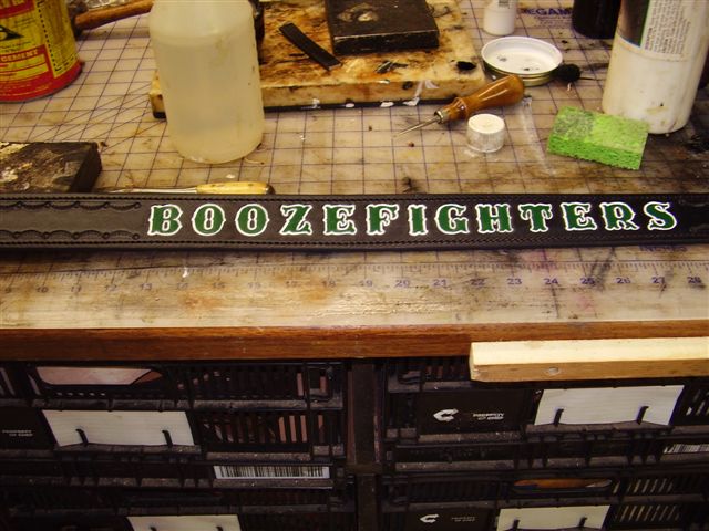

sorry to hear about the black dye comming off..
This is what i do.
Dye with Fiebings Black Oil Dye 2-3 heavy coats.
let dry...... Buff untill no black dye comes off.
then FINISH WITH TANDYS SATEN SHEEN........... :red_bandana:
