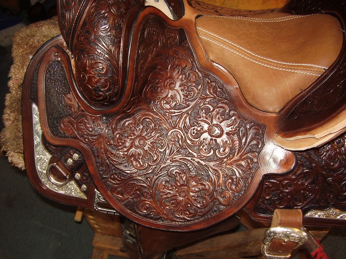

Beautiful carving! You must have tons of experience doing this because it would probably take me at least 5 times that long to do one side. Seriously, one of those sides would take me at least 20 hours to get it finished with all that beveling. I guess I'd never be a good saddle maker. :)
Well, however you did it, it sure worked out nice. I really admire people that can create patterns like that. I really like the way it all intertwines togeather. You also did a really nice job of carving it.
I think there is a lot of difference in carving leather. Some leather can take repeated wettings and drying out in between without to many ill effects. Other leather when let to dry and rewet seems to swell and erase previous carving, turns to mush, turns hard as a board, etc, etc. On a lot of the pictures I carve, especially the embossed ones, my leather dries out between steps because it has too. On a flat picture, or something like a seat on skirting, the old method of casing (soaking completely and letting it sweat in a bag for awhile) is probably going to give the best results, and covering parts of the seat with plastic is going to keep the parts you aren't working on at the time from drying out. When I cant finish at one time (which is almost always) I cover the piece with plastic and if it's going to be a long time before i get back to it, stick it in the fridge. I also spray water on the piece I am working on as it dries out, from the back if it's not glued to something, or from the front. That has worked best for me. I will be interested in hearing what other do to solve your problem.
Thanks. The pattern was cut down from a previous one for a 16 inch seat. This one was 14. I spent tons of time on the original working out the flow and several hours making it work for this seat. Everytime I do one I think it's the best and then the next time I pick it up to use it I end up redoing much of it. I guess that's natural. Once I carve it, I see problems and things that didn't work well. The intertwining vines, or overlaping vines, allows for the flower circles to be placed closer and makes it easier to adapt to an odd shape, like a seat or cantle or whatever. Once you have a the basic pattern of flow for the overlap from one circle to the next, you just keep repeating it from one circle to the next. I use a piece of viewfoil film with my circle pattern on it and a few other cheater features, like the swirls and leaves. Mylar drafting film works the best for making patterns, by the way, but is sure is expensive, now that I'm buying it myself.
Thanks for sharing some of how you go about developing your patterns. Someday I'd like to see a thread here on the different ways people go about doing that. Maybe even some step by steps, hint, hint :begging:
Man, you saddle guys are the true artists of the leather world. I'm trying to think of any other single item that involes as much work and detail, and I can't. Amazing work indeed.

Thanks again for the compliments and tips Keith. I don't have to worry too much about stretch or shrink on my seats down here, although I did get a little bit of stretch on this one. But it has been a real adventure moving from one area of the country where it's cool and wet to an area that is hot as hell and humid one day and dry as west texas the next. It's been weird and hard to get a handle on it but I was very pleased with the outcome on this project. It was slow drying but at least it did finally get there. Last year when we got down here it had been unusually wet and the leather would simply not dry. I have the option of taking the piece outside and letting it take in some hot sun rays to hurry it up a bit.
I will definitely follow your advice about not wetting all the way through and just one panel at a time. It will take all the stress out of it, not having to rush one panel before the others get too dry.
I also like your advice about the pattern grid look. I'll rework this one with that idea in mind next time. Right now I'm breathing a sigh of relief and enjoying the brief resbit. Got notified today that the saddle cleared customs and was delivered to the customer. WHEW! What a hassle that was. With a huge trade deficit, one would think the government would make international trade easier instead of making it more difficult. It was a nightmare of red tape and bureaucratic BS. But it's history now!

what is this flower you are carving? I can't recall seeing it before and its amazing!
The flower is one of my own creation. Got tired of the same ol' flowers, so I came up with that one. I've since developed another one that works well also. I call it a petunia.
