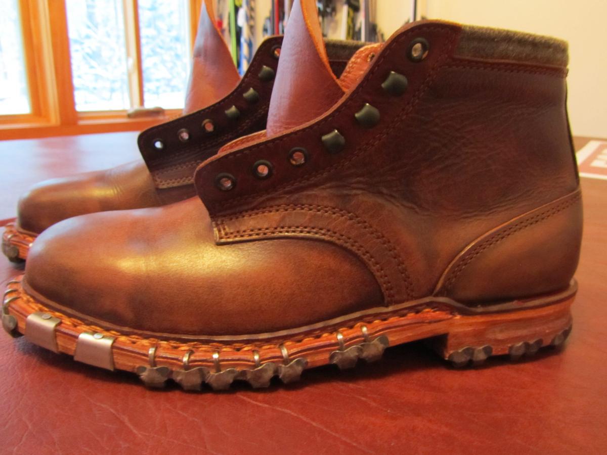

I am brand new to leather work. I am very interested in this topic. I had a pair of boots made for me in Europe (alpine mountaineering boot with cleats and hobnails) and I am in the process of dying them. I used a deglazer first to remove the existing finish on the leather and I have put one coat of Fiebing's Professional Oil Dye in light brown on the boots. I am trying to accomplish a very lighter brown color. I have used Birk 4 a lot in the past on other boots I own and have a large 16 ounce bottle. Can I mix the Fiebing's Oil Dye with the Birk 4? The reason I ask is that the first coat of Fiebing's Oil Dye left the color uneven, except the tongue of the boot. I am hoping to even the dye this morning then work the Birk 4/Fiebing's Oil Dye mixture into the boots to get the even color I am looking for in the finished product. I can send photos if that helps.

Here are some photos of my boots after deglazing and one coat of Fiebing's Light Brown Oil Dye that has been thinned with denatured alcohol at a ratio of 3 to 1 (3 parts dye to 1 part alcohol). The thinned dye was applied with a wool dauber. I am debating about putting a small amount of dye on a cotton rag and lightly touching up the lighter areas. Or blending some dye with Bick 4 and rubbing that it to even the color. What is everyone's thoughts?
I plan on putting Bick 4 on the boots after the dying phase, then coating the boots with Fiebing's Snow Proof Water Protector to waterproof and seal the boots.

YOU SHOULDN't use more then a few drops of the dye with the Bick 4.More is not better in this case.The pigment from tIhe dye will lay on top.I think Springfield Leather did a video on it.
