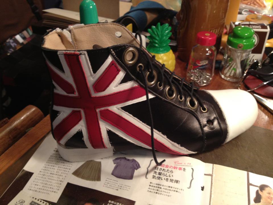

I made a kinda neat shoe/sneaker thing.
This one was just a sample as I get used to using special shoemaking tools, the last, etc. The final version will have an actual sole and a wedge heel built into the sole rather than the simple block heel without any sole at all as in this photo.
I also opened up an extra lace hole but decided not to put a loop in it as the holes were too low for my liking.
The cuts done to the leather stripes of the Union Jack were pretty rough as I used a pair of leather scissors for them. Next time I'll just use a Japanese cutting knife which cuts perfectly straight lines much more easily without the fuzz and jagged edges.
Next time I'll try to make the stitching straighter but I'm only used to hand stitching, machine stitching on leather is a bit tougher to keep straight for me, especially with all the curves going on.
P.S. I'm not British! This kind of pattern is just popular in Japan among young people at the moment.

I am impressed. I can barely tie my own shoes let alone make one. Very nice.
Good job so far. Will you be finishing them yourself?
You can get rid of the fuzz before you sew the pieces next time with a flame passed quickly across the back edge.
But of course a sharp knife is critical to seeing advancement.
Keep up the good work.

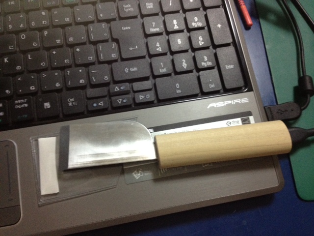

Would like to see this Japanese cutting knife if you could post a pic!
Hey Nick,
Here's a picture of the Japanese knife.

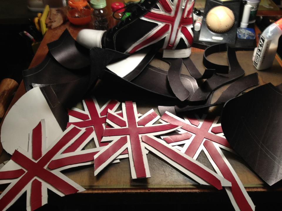

I started on the final pair earlier this afternoon. Here's how far I've gotten after a few hours worth of tracing, cutting and gluing. Next step will be to sew the stripes of the union jack, then I will sew all the parts of the shoe together.

gluing and cutting out the pieces. i've already since sewn everything together since taking this pic.

I've seen these knives for sale. I keep meaning to add one to my arsenal of tools. Got to love that picture, it looks like the knife is USB powered. lol
