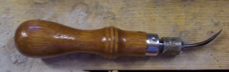

I made my own curved awl blade for doing edge to edge seams. Tried making one like in AS's book, but evidently the needles I used weren't high enough quality. I have one of those four in one tools with the large and small leaf shaped awls, scratch awl and lacing fid. I wanted the awl to be narrower than the smaller leaf awl so I took the fid haft and curved it like Al did the needle in his book then shaped it into a leaf shape with small half round files then round hones finally stropping it on leather glued to a dowel coated with rogue. I've attached a couple of pictures of the tool I made and one of the seam on a pool cue case which was the first time I'd tried edge to edge seams.
When I made the holes I ran the awl through with it tilted at an angle as they should be. Then saddle stitched. I'm a big fan of saddle stitching.
