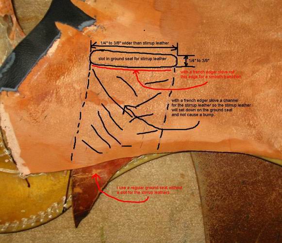

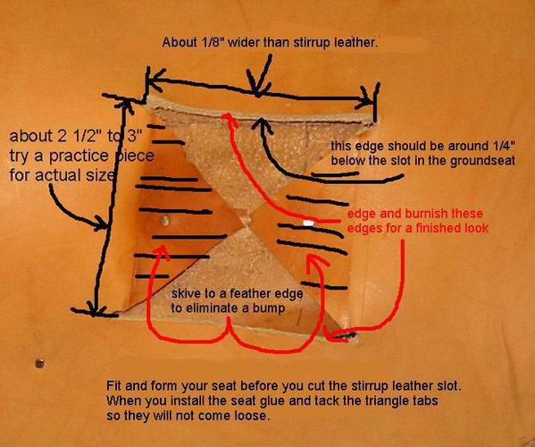

A loop seat is not all that hard. Take your time and try to do a practice one on just one side. Here are some notes I did over 20 years ago, so they are a little crude.
