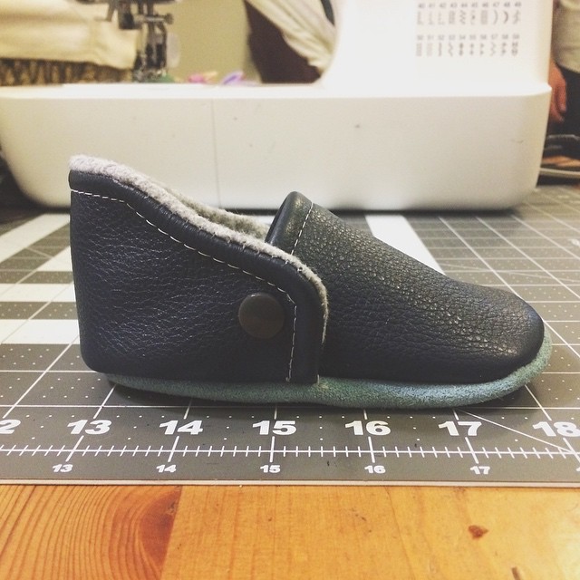

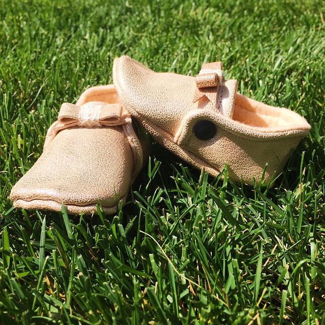

I'd love help finding a Sewing machine that can sew through 2-5 layers of 2-4 ounce leather....Cow Hide, Goat, and deerskin is what I normally use. I have a Brother cs6000i right now and it does fairly well with thinner leather. I am making baby shoes/moccasins and have up to $1000 to spend, but $700 would be better :) I read through the amazingly informative sewing machine post, but I am still lost in the sea of machines!!

Sorry Chelsea, i know nothing about sewing machines as i hand stitch everything, i could not help but tell you how fantastic your shoes look though.

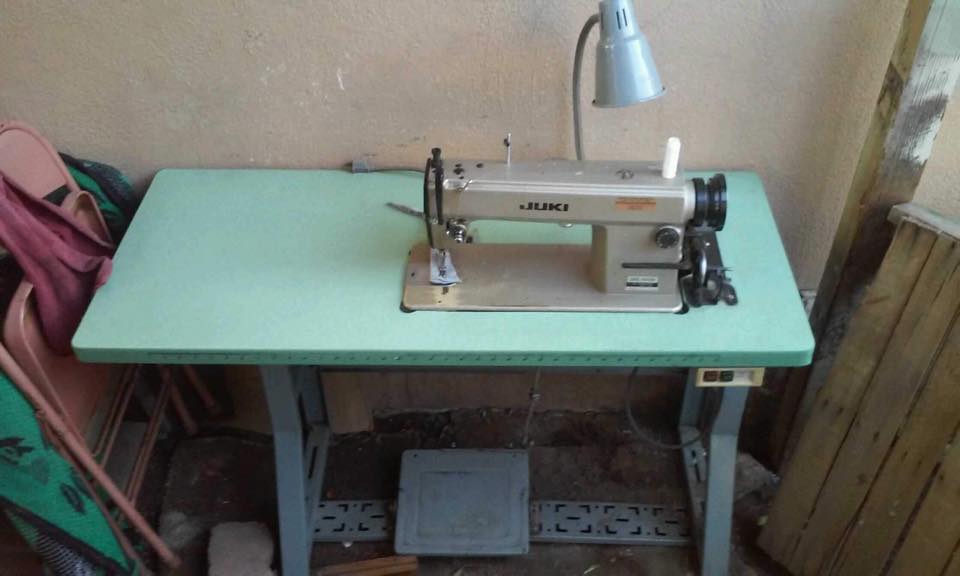

This is a Juki DD 5550, could something like this work for what I need?

Forget the 29-4, it is a shoe patcher that you buy when you need it. They are cantankerous and have what may be the smallest bobbins on the planet. The 5550 is a good machine for flat work, such as sewing (decorating) boot tops of 4-6 oz leather. The Highlead might be a good buy, if it is a needle feed (looks like it has a safety clutch) 618 type so much the better. Remember, that is the type of machine that comes with a safety clutch, speed reducer, and servo motor NEW for $1595 and you should assume an older one without all that stuff should sell for way less. An older one may have been used hard and not taken care of, so be careful. If you are in South California, take a trip over to Ontario and see Steve Tayrien at Leather Machine Company. Take some of your leather over and sew it off, push him for a deal and make him deliver it for free. Get what you want and need so the machine will last a long time. Paying a little more is ok if you only have to buy it once.
