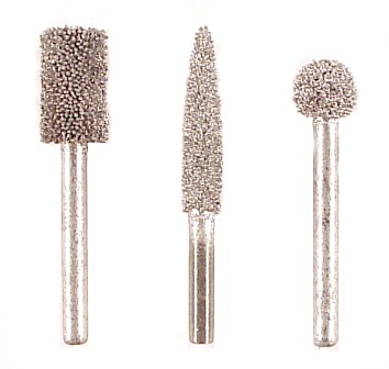

Leather is quite a differant material from the firmer bodied materials like plastic, metal, wood, etc. that rotary tools work best in. To cut leather cleanly with such a tool, you would need a super sharp bit with very acute cutting edges. The only bits that I can think might work okay are the structured tooth carbide burrs that look kind of like a prickly burr.
Whatever you use, you are still going to have some trouble with the oils and resins in the leather gumming up the bit.

Having said that, you can improve your cutting if you use the smaller dental bits like these.
You have to take lighter cuts than with the dental drill but you can still get good results.

LOL Those are a ways from being dental bits, unless you are talking about an elephant dentist ! Dental bits for people are about a 1/16", or smaller.
they are there in their store, you just have to sort thru it. But, if you have a local dental supply house that's good too.
Keep in mind these are 1 use only bits, so if you may also persuade your local dentist to same them to you.
