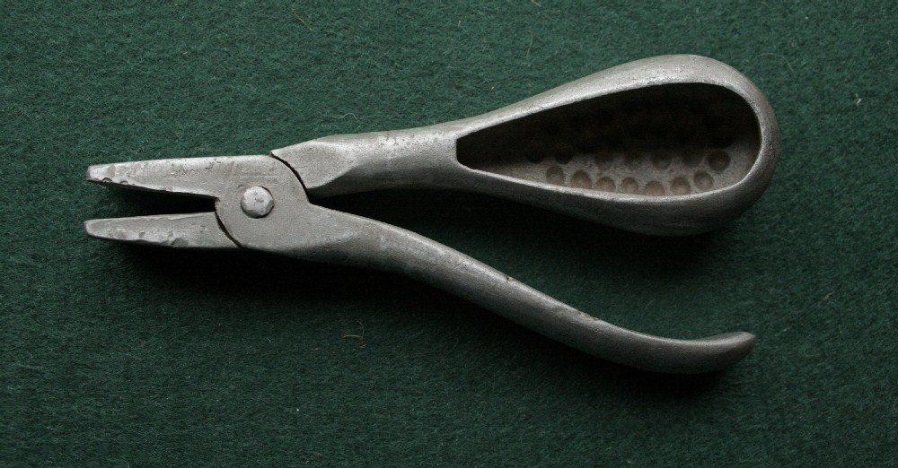

post-5220-085853600 1285650295_thumb.jpg Amongst an array of old Saddlery tools I bought from an Estate was this unsual Collar Palm. It was rusted and the pin worn so my Husband bead blasted it and replaced the pin. When it was polished the makers name was revealed - Dixon. It is a great tool for hand stitching. The ends of the pliers have a half circle cut out the end, the same as a normal Collar Palm does, and can be used the same way or you can pull the needle with the pliers jaws which are smooth.
I have never seen a tool like this, does anyone have any idea of its age?

Mr Dixon is a memeber here. Pm him, I'm sure he'll be able to answer. Make sure you fill us in, too.

The Saddler who owned this gear was the last "Master" Saddler in our area. He definately was repacking and relining saddles as part of his work. I emailed "Mr Dixon" and sent a photo of the pliers, to date havent had the decency of a reply.
