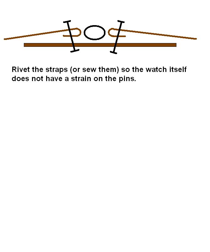

If you are using this just for a cuff, . . . punch the holes in the strap, . . . put it on your wrist, . . . mark the holes in the cuff through the strap, . . . set your rivets there, . . . and you should have no problem.
If you are going to use this for a watch cuff, . . . your friend will probably be back in a couple of days with the pins broken that hold the strap to the watch. Those pins will almost never work this way. The pins for a watch cuff need their own loops.
See the little diagram below for how to attatch straps for a watch cuff.
May God bless,
Dwight
post-6728-0-99196900-1379848321_thumb.jp
Cut two slots somewhat close to each other in the middle. Then cut a slot on each end. Thread strap.
