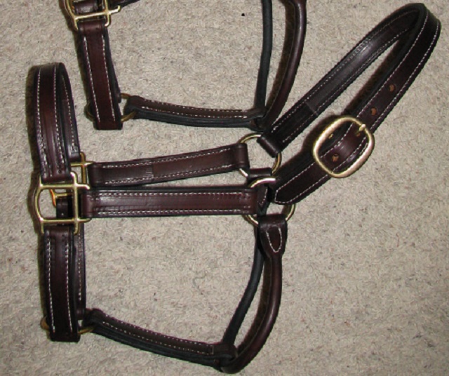

Thank you for the tips. I started off this project by purchasing a rounder. I have some English bridle leather that I think I will try to make a few rounds with. Do you have any pictures of your work?
Here are a few pics I had saved on my computer. There is a set of sidecheck rounds at the shop made from Hermann Oak Rosewood harness leather that are too cool, but I don't have any pictures of them. None of these pictures really shows the sewing channel very well. if you'd like, I can try to get more and better pics tomorrow. I have 2 sets of winker braces in the molds overnight that I made today and will be ready tomorrow; the last picture shows the rounded portion of the braces on a bridle I made a few weeks ago. I was fascinated by the rounded bridle sidechecks on Grandpa's old work harness when I was a child, and spent years trying to figure out how to make them. It was a long process of trial and error, and I really didn't figure it out completely until one day maybe 8 years ago, I spent an entire day doing nothing but making rounds. I experimented with different leather, splitting to different thicknesses, thinner or thicker fillers, etc. One of the trickiest parts is turning the lap smoothly back into the round and splicing it with the filler so as to leave a perfectly even transition. Take your time with every step until your satisfied that it's perfect, because the success of each subsequent step is dependent on the previous one (like so many other things in leatherwork--and life). Getting it split to the right thickness is also very important. There are few things more gratifying to me than a finished round, perfectly even and smooth. And , NO, after all these years, they still don't all turn out that way! I'd probably get fired the first day if I worked at Freedman's or some other prestigious shop.

Another thing, and I don't know if it's mentioned in the Leathercrafter's Journal article, but make sure you saddle soap the leather well before you pull it through the rounder. It really makes a difference. And moisture content is critical throughout the entire process.
