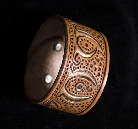

Hello everyone,
I have learned much reading the threads in this forum! the purpsoe of this message is to buy the right two tools. my funds will not allow me to exceed two well made bevelers so my question is size and maker. all opinions appreciated! I am learning but prefer to "buy right" from the get go....I am at the point that I want to commit to at least 2 serious (well made) bevelers for a design I do. the cuff widths I am working at this time is 1-3/4" 2" to give an idea of carving size. I am open to hearing everyone's opinion and hopefully share with us their two favorite bevelers acompanyed by an image of the work. I am so excited to see the results thank you in advance I feel it will be helpful for many of us to learn of the tools the craft-smith rely on above all other tools. this design is in a preliminary stage the beveling is on the symbols that is the design element that will remain and be beveled.
thanks again

I use old Craftool bevelers that are 30 something years old. The two I use the most are B203 and B60 ,with B203 being irreplaceable.I also use B790 quite a bit. I recently bought a nylon beveler blade from Kevin @ Springfield Leather and it's way cool! It's used mostly for borders and beading. I used to have a Barry King beveler but I prefer the old ones I have.You can see some of my junk on the board and on my profile page.I like your work, looks really cool!
