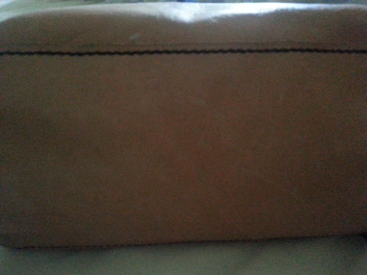

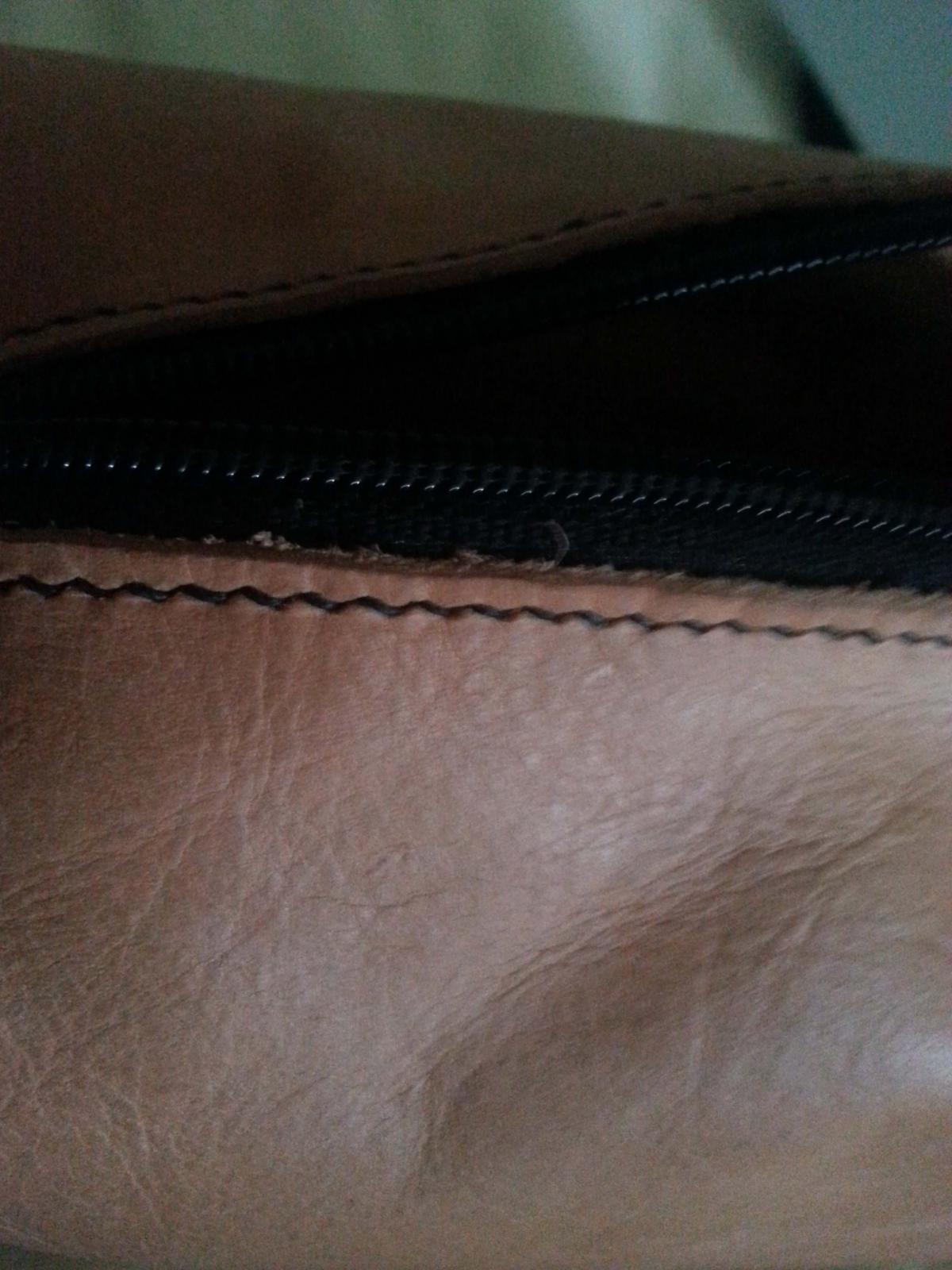

I bought this set: http://www.amazon.com/gp/product/B00CBRVKOK/ref=oh_aui_detailpage_o04_s00?ie=UTF8&psc=1
I use it to make mark where I wanted to put the holes on the finished side. I did not mark the back side except for a groove to line up the awl when it came out the backside.
Because I am rather new, I have bought numerous threads and it has been hit and miss. I bought some Thread Exchange. One shipment was too thin (thread for machine sewing) and the other was too large for the diamond awl (waxed polyester #554). I ordered some 1mm from Ludlow a few days ago and am looking forward to trying it out. Now I am afraid it may be too thick and I should have ordered the .8mm.
I am making a leather clutch out chromexcel and I think it may be too thick. It was my first craft leather purpose. I do not know the exact thickness because it was scarps from Aurora Shoe Company. I will order a 5 or 6 ounce next time unless I find out that is what I have now. I pretty much have to order and compare different products because I do not know leather people here. My first three projects looked much better than this past one because I used a 4 prong hole punch which leaves a pretty large whole that I am pretty sure rope could fit through :)
With this leather and the diamond awl, I found the holes to have hardly a diamond shape.
