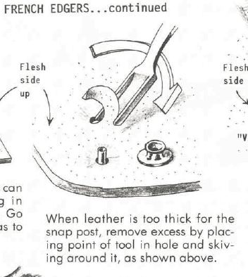

If you have a french edger you can try this trick from page 38 of Leathercraft-Tools-by-Al-Stohlman. Its really easy and works well for me.
post-22515-007848500 1333876369_thumb.jp
