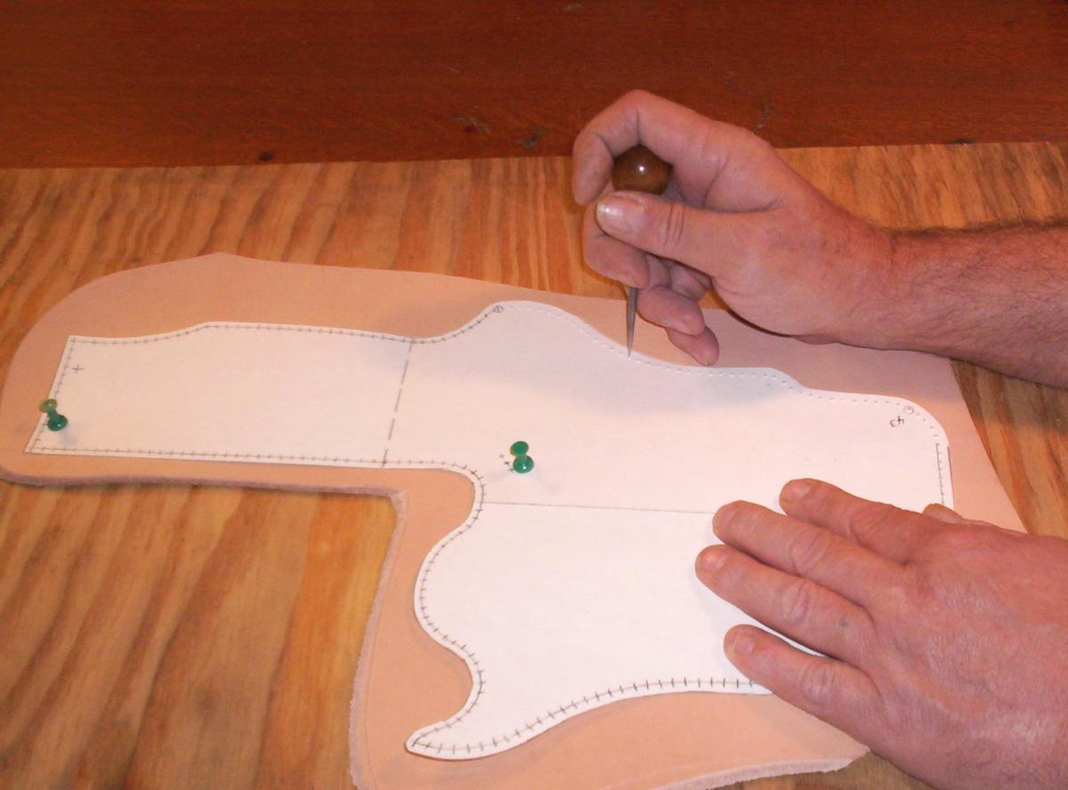

From experience I learned that if the tracing on the leather is not exactly the same shape and size of the pattern template then something is going wrong. Most often the pattern is moved during the tracing process.
A simple fix to this is to use Push Pins and insert them into existing holes that will be punched for stitches, rivets, or snaps. Then trace the pattern with a scratch awl right along the edge of the pattern. This works for small to large patterns.
My personal choice for cutting is a utility knife because it gives me control and a good smooth cut so I don't have to use a belt sander to trim it up.
See the photos.
Hope this helps.

This is the question: I would like to know how to layout the stitch line on the patterns as shown in the pictures in Jim's post? Also, what tool do you use for spacing the stitch holes? I would like to make my mistakes on paper.

I use a divider to trace out the desired distance from the edge and then use a chisel to punch holes, you could also use a stitching wheel along line to get hole spacing
