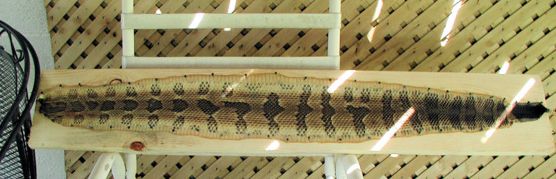

Yuck - I do not like these legless beasties. However, I now have one that is skinned and tacked onto a board and taking up space in my garage. (Timber rattler 3+ feet long, 6 rattles)
The hubby would like to make a hatband out of it. I have no idea what to do to dry this, cure this, treat this, etc. to make it appropriate for a hatband. Just air dry? What can be put on it to keep it from becoming crispy?

You've done the first steps, and now you'll need to get something like 'rep-tan' (Tandy). There are quite a few products on the market, and really, I suggest googling the subject for the one best suited to your needs. You'll also need to descale it, and once the hide is tanned, condition it. Due to the very thin nature of it, some folks recommend overlaying the snakeskin on something a little more substantial- 2-3 oz cow, pigskin, goat....you get the picture. This is to help prevent tearing of the snakeskin when used on something that might see abrasion, stretching, and what not. If you were just going to make a wall hanging out of it, you could effectively tan it with antifreeze (but that's probably not good for a hatband).

This is what it currently looks like.
