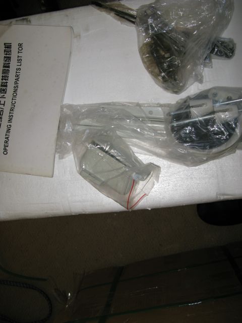

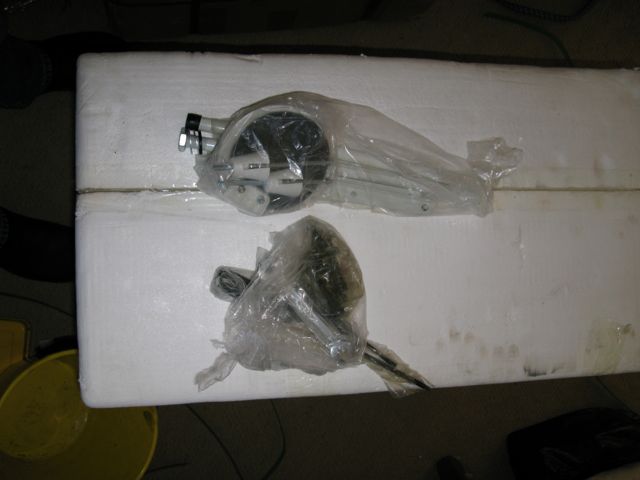

That's when I hit the second snag, rather than reading the labels on the boxes and the instructions with the shipment, the freighters just put three random boxes on a pallet and sent them to me. I got my 441 head fine, but found two clutch motors and a Sailmaster zigzag machine in the boxes I was expecting the stand in. Annoying, but no fault of Hightex or the chap I bought the machine from.

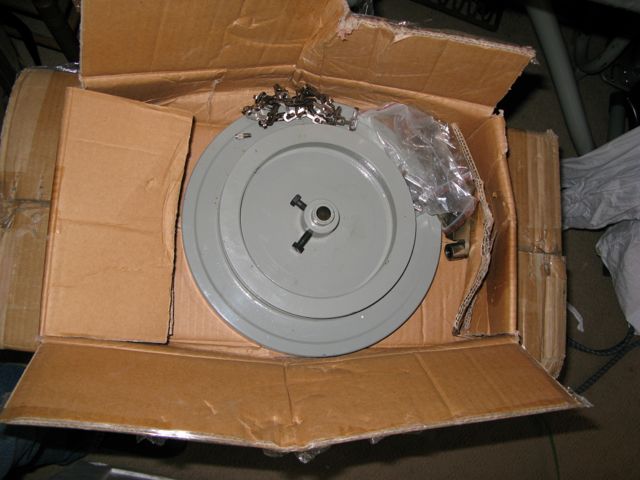

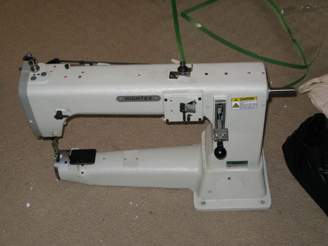

The machines arrived on a pallet in cardboard boxes. The boxes had taken a bit of rough handling but the internal polystyrene liners were undamaged. In the main box was the head, manual and parts, and a smaller box with the wheel and thread stand. Most bits were in plastic bags.
post-13283-011292200 1320448834_thumb.jp post-13283-077932300 1320448835_thumb.jp post-13283-090703000 1320448840_thumb.jp post-13283-090104100 1320448838_thumb.jp post-13283-030314400 1320448837_thumb.jp post-13283-072948100 1320448848_thumb.jp
The machine was greased for shipping and wrapped in plastic. They could have done a better job greasing and wrapping the hand wheel, it had some rust on it when I unboxed it.
post-13283-097120100 1320448844_thumb.jp post-13283-069383300 1320448846_thumb.jp

I mean, they forgot sewing stand parts and sent a sewing machine additional instead? What the heck is that all about, in this case?

It was interesting to observe the build quality of the machine as I reassembled it. It is very much as I expected on a machine at this price point; the machined surfaces are even and clean and the castings aren't bad but are only machined on mating surfaces. The general fit is good and I didn't find any major loose parts or screws but there are minor bits of fit and finish that just need a little bit more time spent on them.
The castings of the feet and needle plates are pretty good. They're finished to a high polish on the surfaces that matter but with the sort of polished finish that belies the fact that they didn't see much in the way of surface grinding to fine grit before going to polish. That doesn't affect their utility but it's an interesting contrast with the standard needle plate which is a fine and even satin finish and seems to be of a different quality, possibly because it's stamped from sheet rather than cast.
The double-toe presser foot didn't want to go on the bar at first and needed a bit of filing before it went on, likewise one of the inner feet (they sent me two) needed going after with a 5.5mm drill bit before it would go on the presser foot bar.

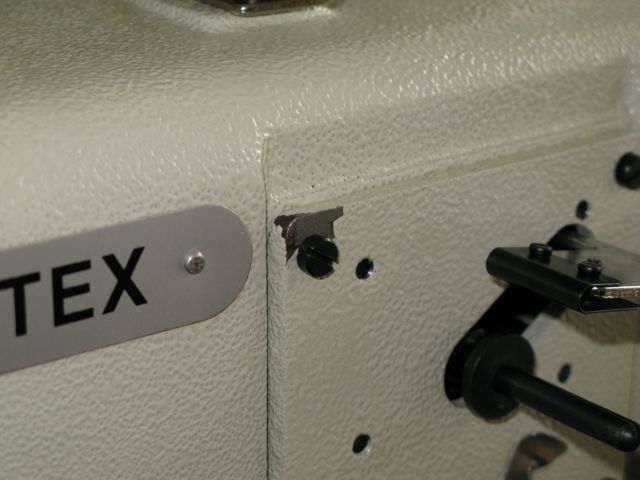

The paint shows evidence of insufficient surface prep in places. This isn't surprising on a machine at this price since good surface prep for paint is very time consuming, and therefore expensive. I think that's something which sets more expensive machines apart; the Highleads I've seen have had really good paint, and I've got old Pfaff and Seiko machines with paint that is still perfectly good (if dirty). The paint on the hand wheel was showing signs of light rust through when I unpacked it which cleaned off fine. Again, something I'm prepared to live with for a machine at this price point, and not out of the bounds of what I was expecting.
The one place the paint on the body of the machine failed in a way that I might have to care about is on the corner of the bobbin winder assembly where the paint cracked off as soon as I got the screw even slightly tight. If it bugs me enough I'll take it along to the local powder coater with one of the loads of other parts I'm getting done and see if they have a coating that matches.
post-13283-088410800 1320821572_thumb.jp

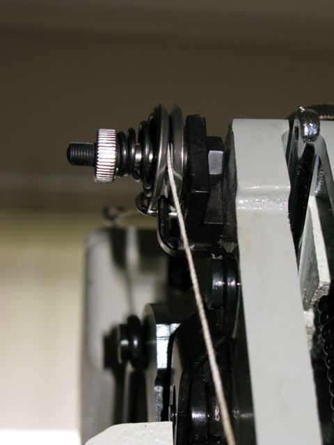

One part that took me a while to figure out was the tension release which wasn't connected into the foot raising mechanism when I unboxed the machine. It took a bit of staring to click as to what it was when it was just dangling off the side of the head:
post-13283-007532500 1320821576_thumb.jp
It's supposed to be connected like this:
post-13283-001029400 1320821578_thumb.jp
What it does is that when you raise the foot it wedges the main tension discs open so the thread can be pulled through, allowing the work to be withdrawn from the machine.
post-13283-082771500 1320821579_thumb.jp

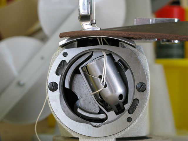

The bobbins are cast aluminium and seem perfectly good. The hook is pretty much what I expected, which is to say I think it'll work with a bit of fiddling about, but I'll replace it with a Hirose one as soon as I've got the money. It intermittently catches the thread either on the spring or on the back of the hook as it counter-rotates. It's possible this is caused by a timing problem, but if it is it's one that's too subtle for me to work out just now since the timing looks fine to me.
post-13283-053202500 1320821569_thumb.jp post-13283-014741400 1320821571_thumb.jp
The finish of the bobbin case under the tension spring also leaves a bit to be desired and intermittently shreds the thread when withdrawing the work from the machine. This might well be operator error but if I can't figure out what I'm doing wrong I'll go after it with the dremel and polish the thread path, being careful not to sharpen any of the edges.
Shipping the wrong type of motor was the factory's fault, the other bits were the freight forwarder stuffing things up. My machine wasn't as shipment on its own, it came in with other things the reseller had ordered at the same time. The freight forwarder received the whole shipment at the docks and rather than following their instructions they just sent three random boxes to me and the rest to GLH in Queenstown where the rest of the shipment was destined for. In hindsight I think it would have made more sense for them to send everything to Queenstown, sort and verify it and ship my bits back up to me in Auckland, even though that would have added cost and delay.
